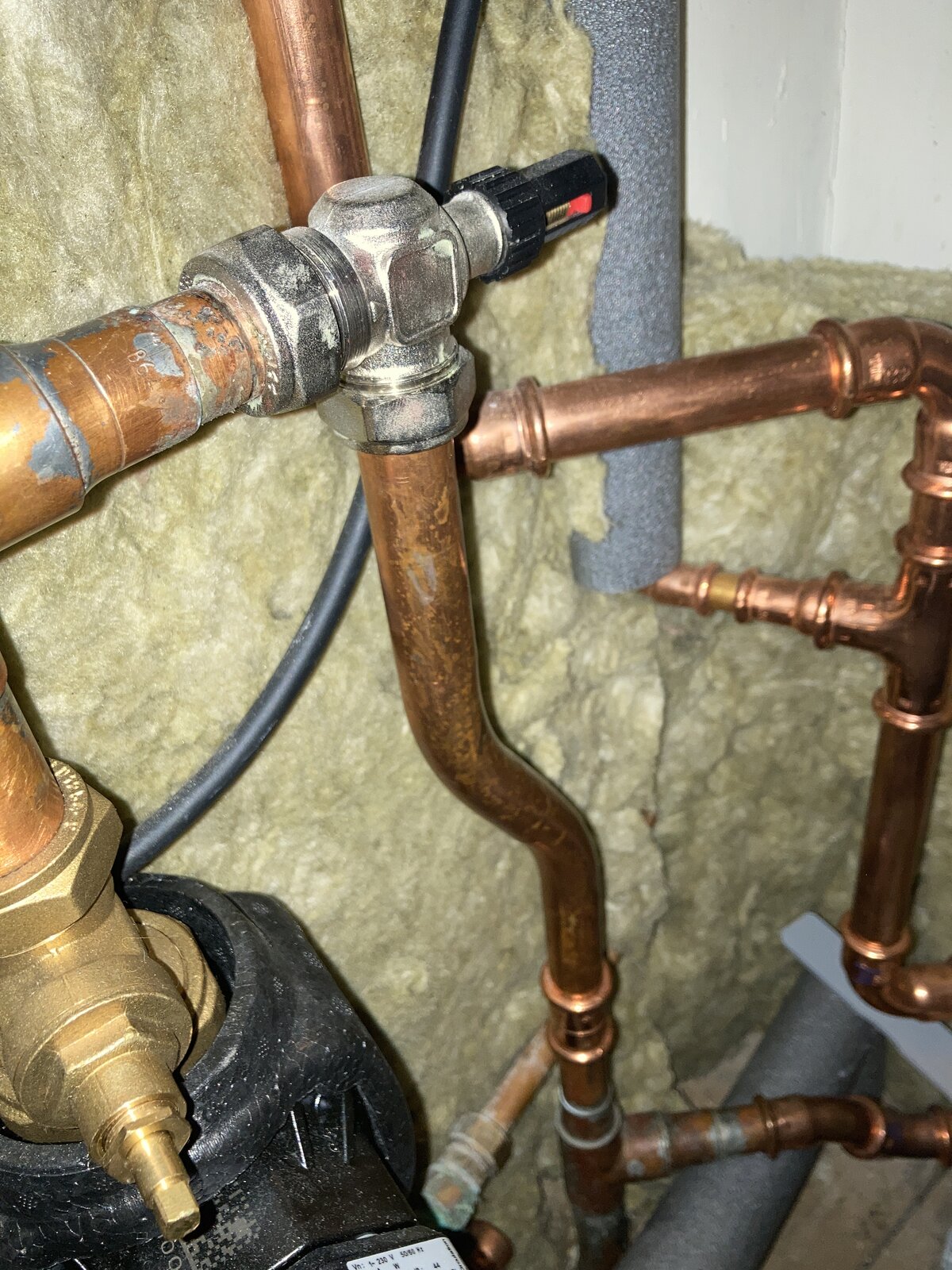

I think I do have a bypass valve which reminds me that I did ask on here what to do with it. I must admit I found it a bit tricky to understand how I was supposed to adjust it. Likewise with drawing the system. I don’t think I understand enough about it and where all the flow and return pipework is- especially what all the pipework in the airing cupboard corresponds to.
To confirm- if I temporarily have a bypass radiator, appreciating this isn’t the best solution, should the lock shield be fully open or throttle back? I can then perhaps ask a heating engineer when I next need a boiler service if there’s a better set up.

Your picture is a bypass valve so your rad shouldn't be used as one. However, that rad could have been flung in without proper placement in the system. It's hard to know tbh. What is, rarely matches what should be.
The red indicator is the setting. You turn the head to set the valve. Google danfoss abv. The setting instructions are there but is really just dead heading the sytem when hot and the feeling for heat on the outlet as you wind back the head. Once that set point is found, you turn 1/2 turn back and job done.
The idea is the valve opens in reaction to pump pressure rising as the trvs close to guarantee a min return flow rate.
Your valve looks to be set at low?
Might not be working at all. They can be sensitive to crud. Easy to clean up tbh.
But, drawing out the system will confirm its in the right place, pointing the right way :)

Throttle it back, not too far or it might not work when you want it to.

This system has a proper bypass fitted. The OP should ensure that's working properly.
Find the problem and fix it.

Denso- as a ballpark how much of a turn (or turns) from closed on the lock shield would you say I should be aiming for?
Close it and open it half a turn. See how it goes.

I see the bypass has been hacked into by the last plumber with press fit plumbing. Nothing against press fit where it's done properly but it's a red flag for hackit plumbing.
Teeing into the bypass? Wtf is that all about?
The trv is bi-directional so should be ok. The system has a bypass so should be ok.
