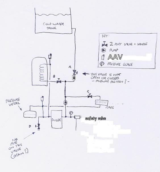

I posted here a while ago asking how to top-up my system.
see here:
http://www.diynot.com/forums/viewtopic.php?p=638940#638940
here's an updated schematic:
http://i187.photobucket.com/albums/x228/Dr_Doolittle/Pipescopy-1.jpg
note:
-valve B is left open, with the handle removed.
-non return valve after valve A
-AAV above pressure vessel is closed.
Anyway, i replaced a radiator yesterday, but after refilling & bleeding, the pressure is only up to 0.5 bar. The boiler works ok, and when it's up to temperature, it's at 2 bar as usual. but then it drops back to 0.5bar when cold.
I suspect i might have to connect a hose from the mains to valve d?
Also, why is the pressure low if the system is full? i.e all rads bled until water comes out.
Any ideas how to get the pressure up to 1 bar?
