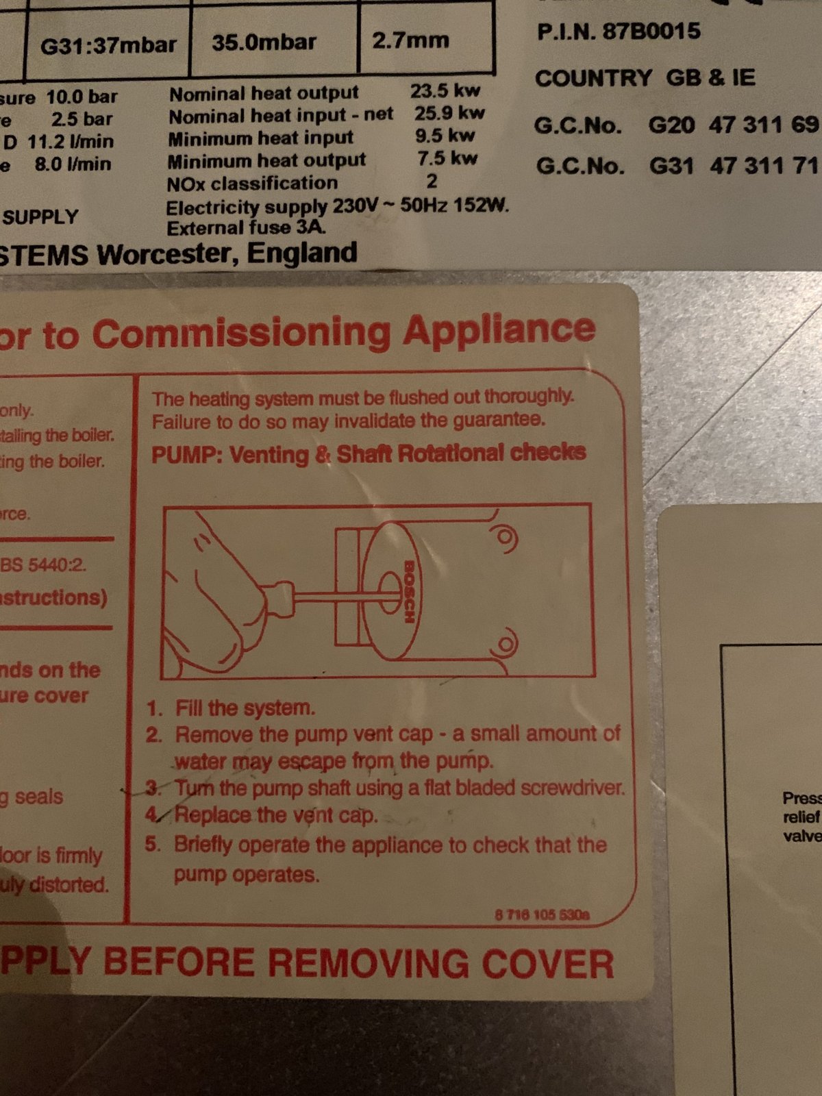

Low pressure on boiler
13 Jan 2020
I am struggling to work out how I can top up the pressure for my boiler - attached/below is a picture of the instructions but when I turn the pump shaft nothing happens. The whole screw eventually just screws off the front. Am I missing something? Can someone please help me? Thanks.
You do not use the pump to top up system pressure . Use the filling loop.
Look below the boiler for a silver braided flexible hose ,or post some pics .
