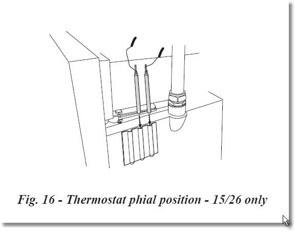

I have a Grant condensing oil fired boiler where the thermostat phials are fitted to the side of the boiler as shown in the attached diagram.
I believe that this is the side of the secondary heat exchanger ? Is this correct ?
In the event of dry firing would this reduce the risk of damage to the boiler ?

It would be better if you just said what boiler model you had. Is it a system/combination boiler or heat only?
Seeing as the flow/return tappings on this boiler are taken from the top of the heat exchanger, unless the boiler itself was drained, it is unlikely (failure otherwise) that the heat exchanger would ever be empty of water and the stats would trip.
Fire the boiler with no water in the heat exchanger and you are likely to damage it.
I recognised your boiler from the picture posted of the thermostats and the manufacturer makes their position very clear. The following is the relevant extract from the installation manual:-
Sealed systems - If plastic pipe is to be used, the installer must check with the plastic pipe manufacturer that the pipe to be used is suitable for the temperature and pressures concerned. Pipe must be Class S to BS
7291: Part 1:1990.
The system should incorporate a low-pressure switch to shut off power to the boiler if the system pressure drops below 0.2 bar. A suitable low pressure switch kit is available to purchase from Grant Engineering (UK)
Limited, Part No. MPCBS 62.
If the above is relevant to your system , I suggest you incorporate the recommended switch.
