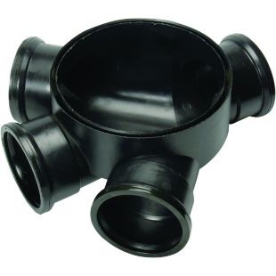

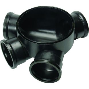

Could you put a small inspection pit outside so you can rod it if it blocks?
