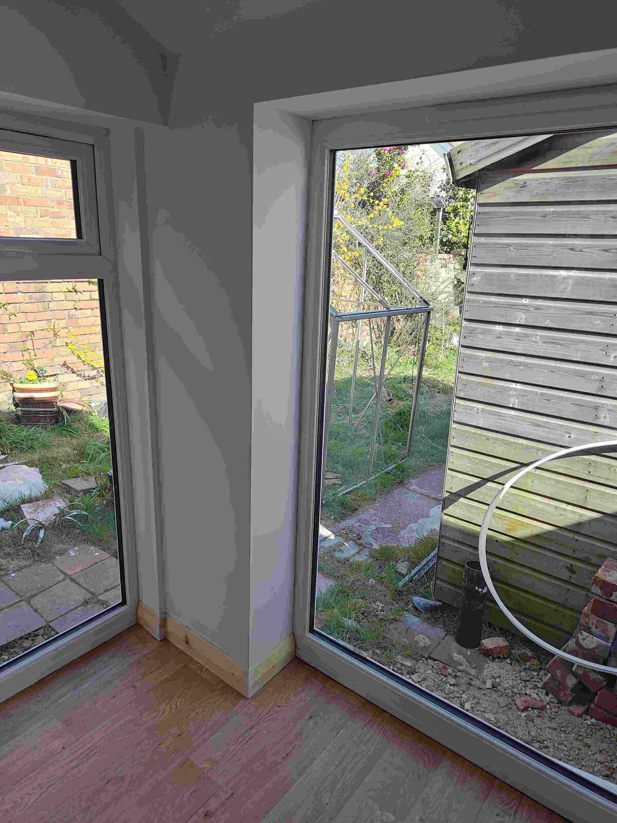

Hi,
I fitted these windows into a former outside toilet coal bunker, and they've just be rejected by building control, because they're not toughened.
I've fitted windows before and know that any window lower than waist height or round a door should be toughened, and when I ordered them I knew that the suppliers would also know this, and didn't consider that they supply none compliant ones, so it was a surprise that they are found to be normal glass.
How would you portion the blame for the error, between me and the supplier?
Cheers, Camerart

Hi C,
1/ I explained what they were for and where they were going.
2/ The left one is a door way, so the bottom is lower than waist height.
3/ Just the size of the opening.
4/ I explained that I was a DIYer and fitting it myself.
I didn't think about the safety glass angle, it was obvious that it should be safety glass, so I took it for granted.
P.S. I phoned another glass supplier today, and they told me, they always ask about toughened, also if it should be heat retaining.
C.

Confused? Anything lower than 800mm from the floor or 300mm from a door needs to be safety glass, how would the supplier know the height from floor unless they were told?
How would the supplier know your window is below 800mm unless you tell them?

As the top of it was quite low, I asked about the frame width so I could assess what I would be able to see, so I did say that it was floor to the lintel.

You can in fact have non toughened glass if there is protection eg a balustrade, a situation which sometimes comes up with adding stairs in an existing building.
I think you just have to chalk this up to experience: you didn't order what you needed and were supplied with what you did order. Put your hands up when you call: I'd hope the'd give you a good price for the right glass but in my mind they are NOT obligate dso to do.
Yes you could but you have to barrier both sides as they both fall within the 800mm, you could also safety film the glass to bring it up to regs but I guess with both solutions your getting close to the cost of replacement glass
Hi All,
This survey showed a high percentage of my fault, but when I contacted them, I put my side, and they agreed, and will replace the glass.
They found my original offer, with the measurements, and the glass is 'in the post' :)
