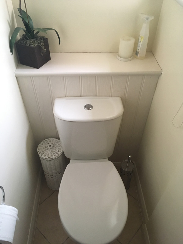

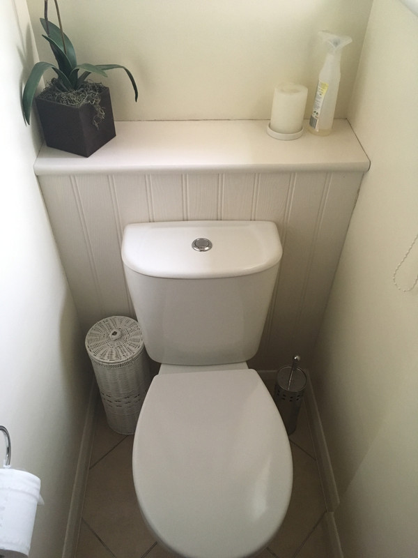

    I’m happy with the Sanislim macerator in our downstairs loo. Basin is plumbed in to it too and you can even add a shower to it if you wanted. I boxed ours in and added some sound deadening so it’s a lot quieter than any other macerator I've ever heard.

    I'm knicking that idea with the boxing in. Looks great
