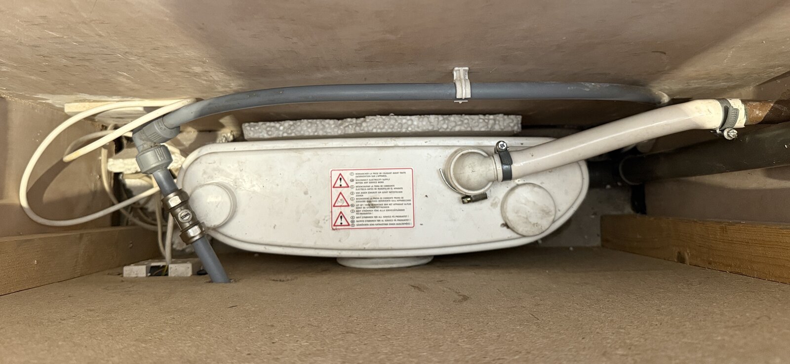

I wonder if @just pumps or anyone else can offer some advice. On our way out last night, I had a wee in the downstairs loo and flushed it. When we came back the house was in darkness, the main breaker in the consumer unit had tripped. By a process of elimination I narrowed it to the downstairs ring and further elimination by switching all plugs and spurs off, determined that it was the macerator. Something has obviously shorted out in there. It’s a Sani Slim. Is it a common fault? 7 years ago it was the capacitor that was replaced but that was a different problem (just humming) and it wasn’t shorting out then. Any ideas? Is it repairable or time for a new one and if so, can you recommend another slimline make (just the wc and hand basin as Sanislims are now £650+.

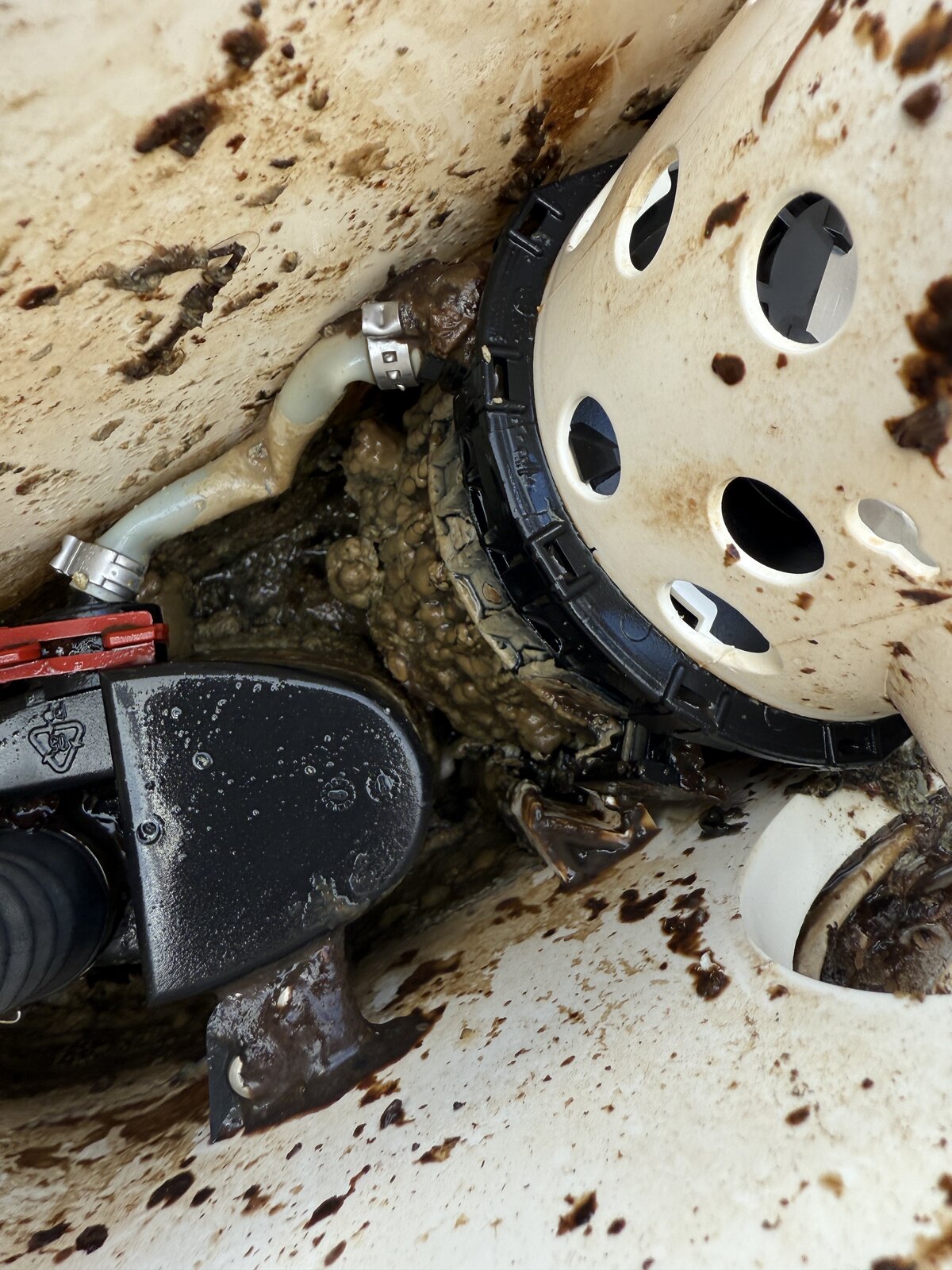

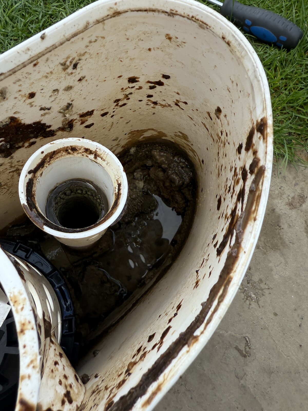

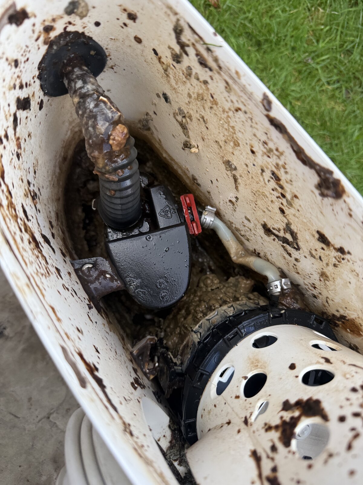

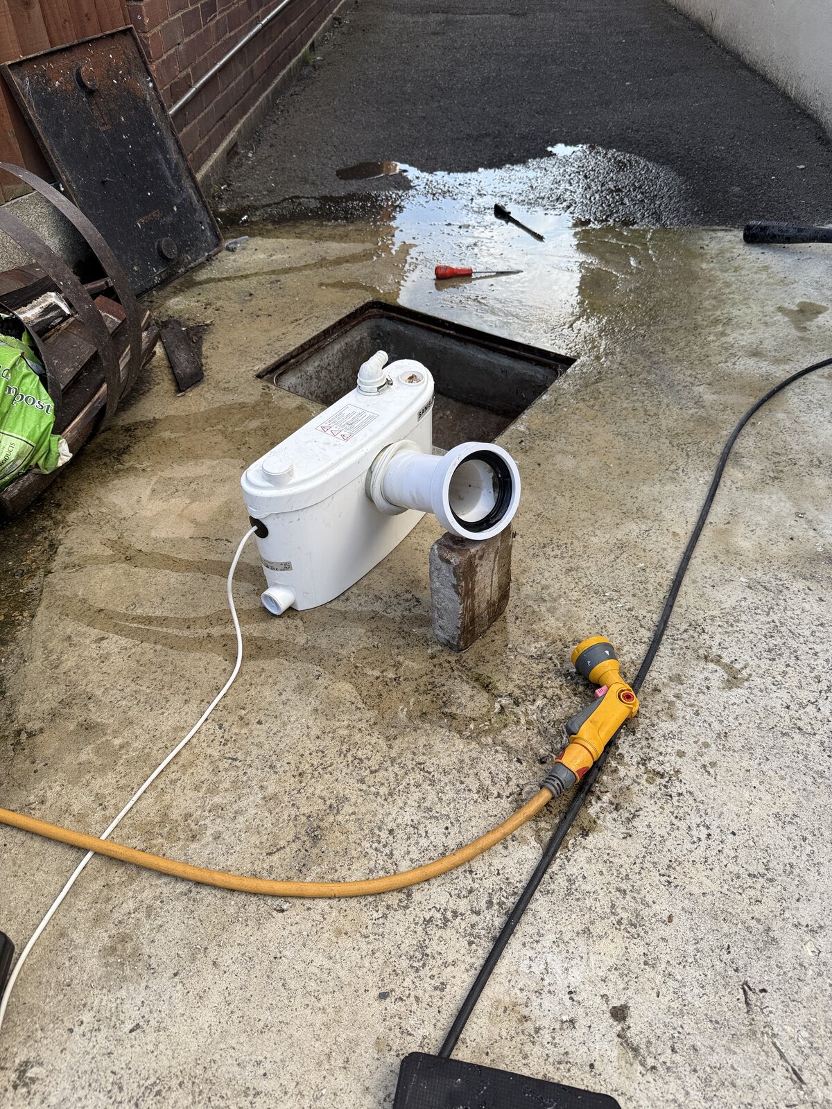

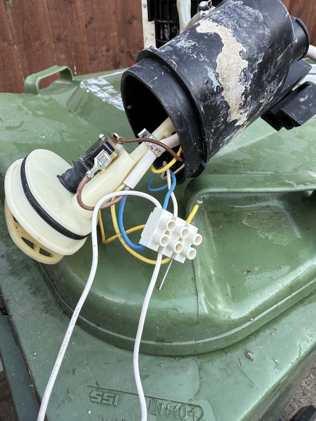

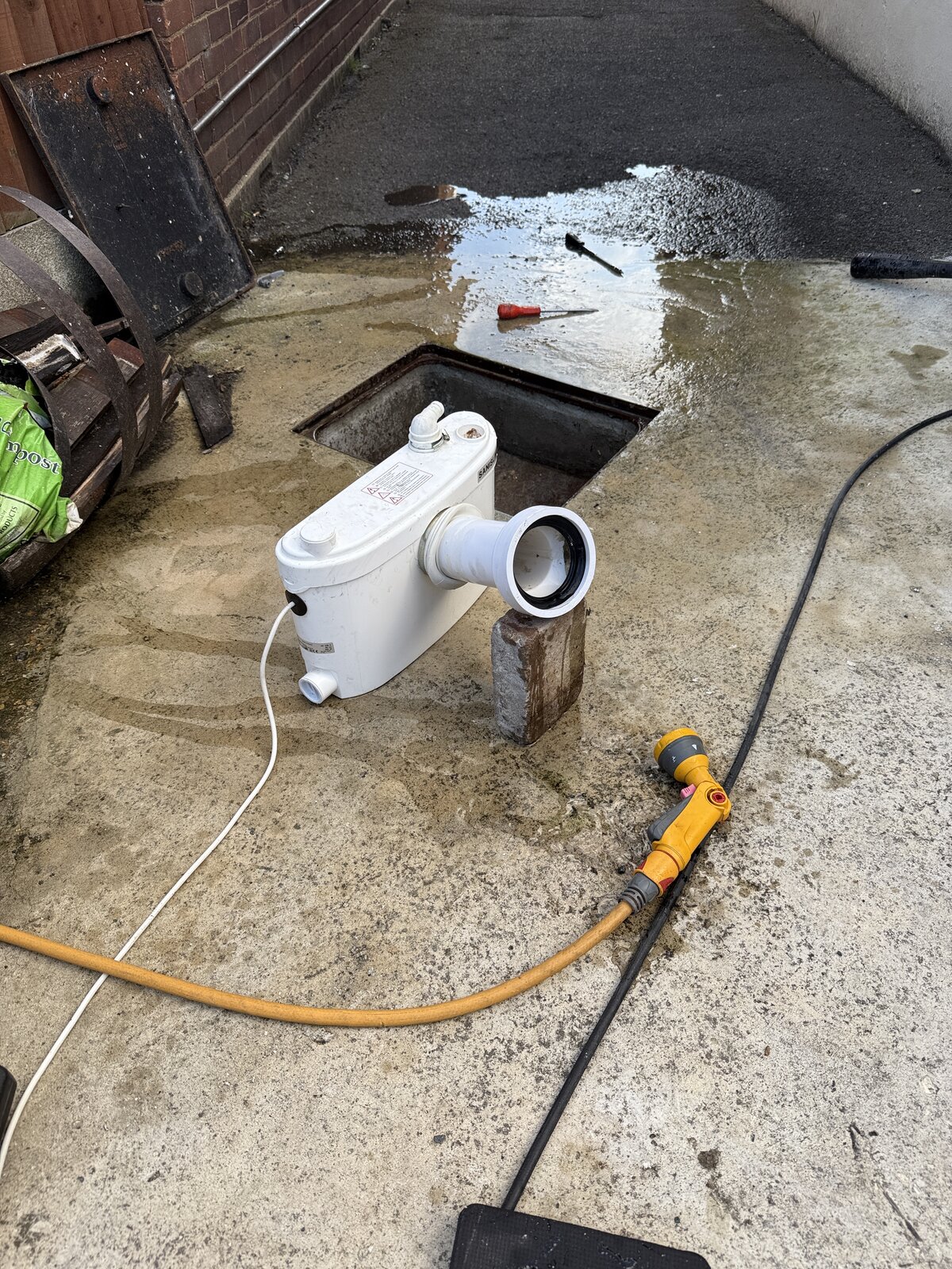

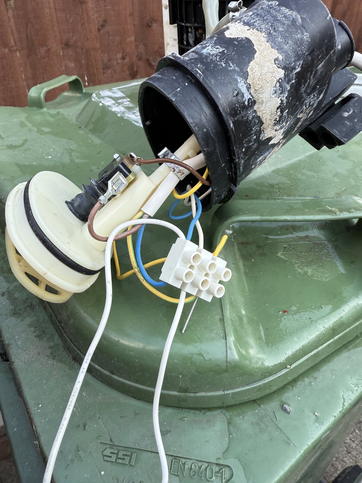

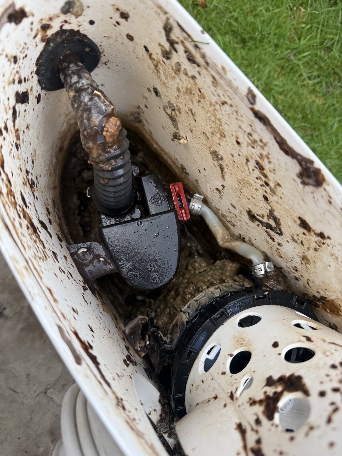

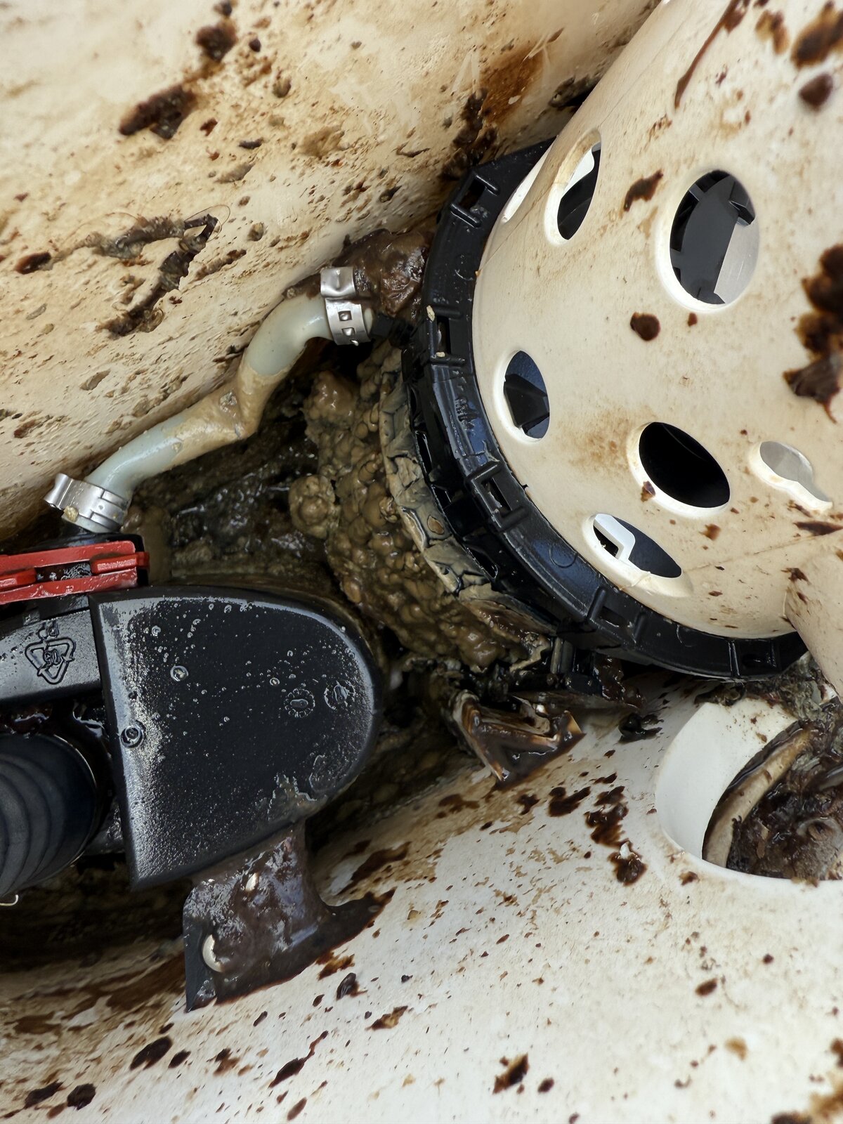

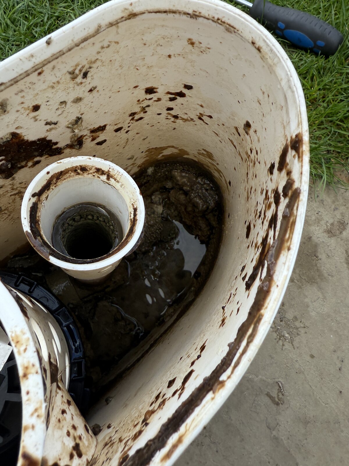

Took it out and stripped it down today. Yuk - considering it’s hardly ever used for number twos! Don’t think it was poo though? Anyway, Gloves, face mask and face shield on and I gave it a thorough clean out with my pressure washer.
Removed the diaphragm and water came out. Blew that out with some compressed air, fitted a plug to the cable, touched the microswitch and it worked fine. Had a good examination of the diaphragm and the cable gland and I saw no signs of perishing. Pretty sure no water could have got in past the diaphragm as that was sound, the oval 'O' ring was sound and the gland/rubber that covers the plunger that operates the micro-switch was sound too. I fitted a new jubilee clip to the cable gland.
Put it all back together, plugged it in and filled it with water from a hose and it started, pumped, started, pumped etc. All good.
View attachment 392160View attachment 392161View attachment 392162

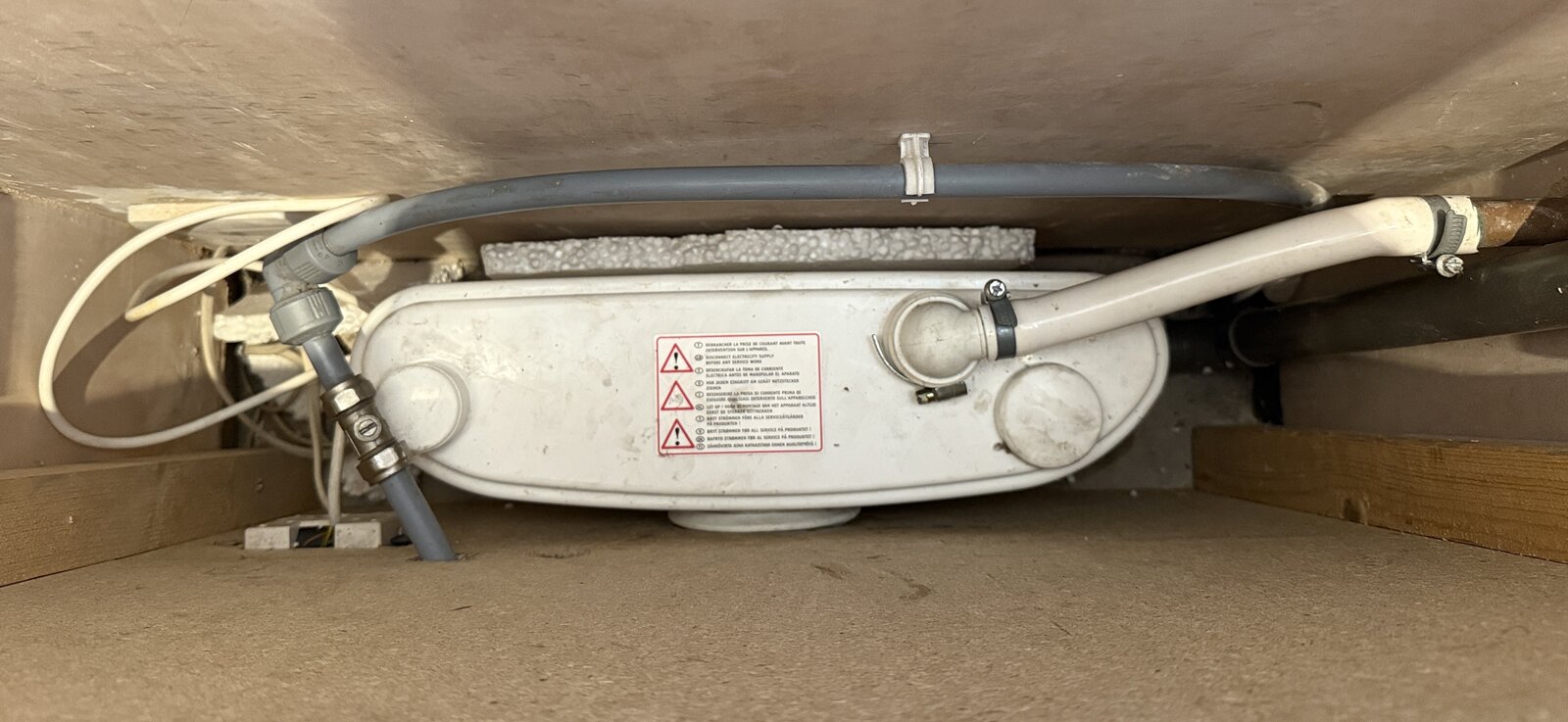

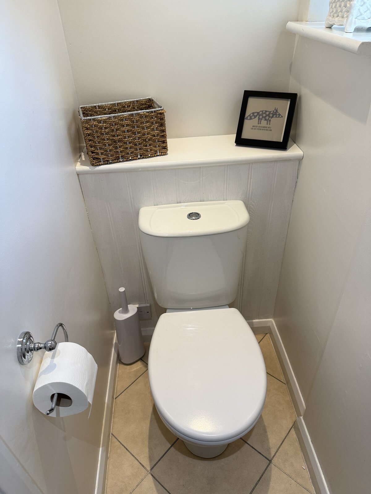

After leaving it full of water overnight (which I presume is a lot higher than the level when it’s pumped out and at rest), I connected it up to the power and it pumped out. I’ll have to assume no water is getting into the electrics. Tried it again for several pumping cycles to be sure and it was all good:
I then refitted it back into place, a bit fiddly but I don’t like it on show plus it cuts down the noise.
Finished boxing up and it’s as good as new!
If it goes again, I’ll change it for the one recommended by Nwgs2.
