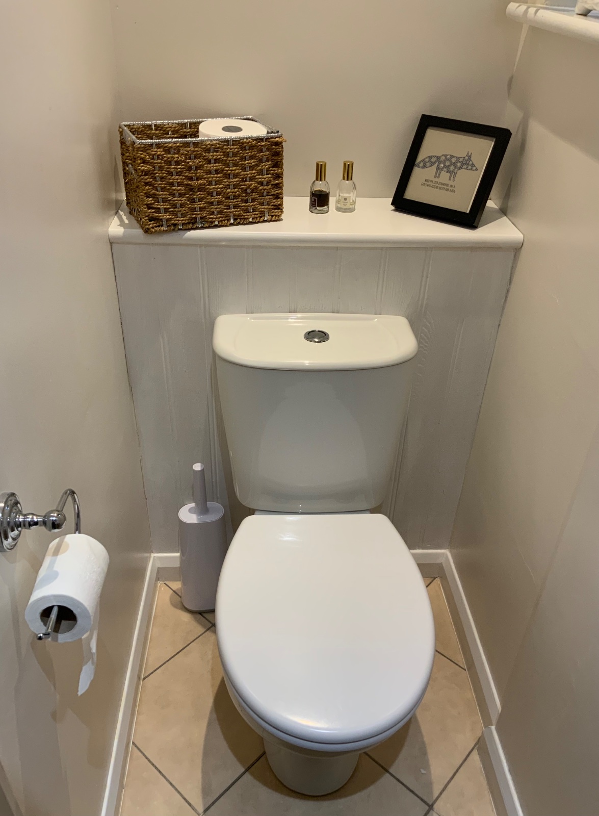

We have a Saniflo slimline in our downstairs loo. They can cope with a wc, basin and shower. Very quiet anyway but I’ve boxed mine in and added some extra sounds insulation and now it practically purrs! I have replaced it once (probably could have repaired it) and with the advice of just pumps on here, repaired the replacement very cheaply. Newest one has been in nearly 20 years.
Cheers Mottie, that is almost exactly the look er indoors wants.
Apart from having a hidden cistern.
