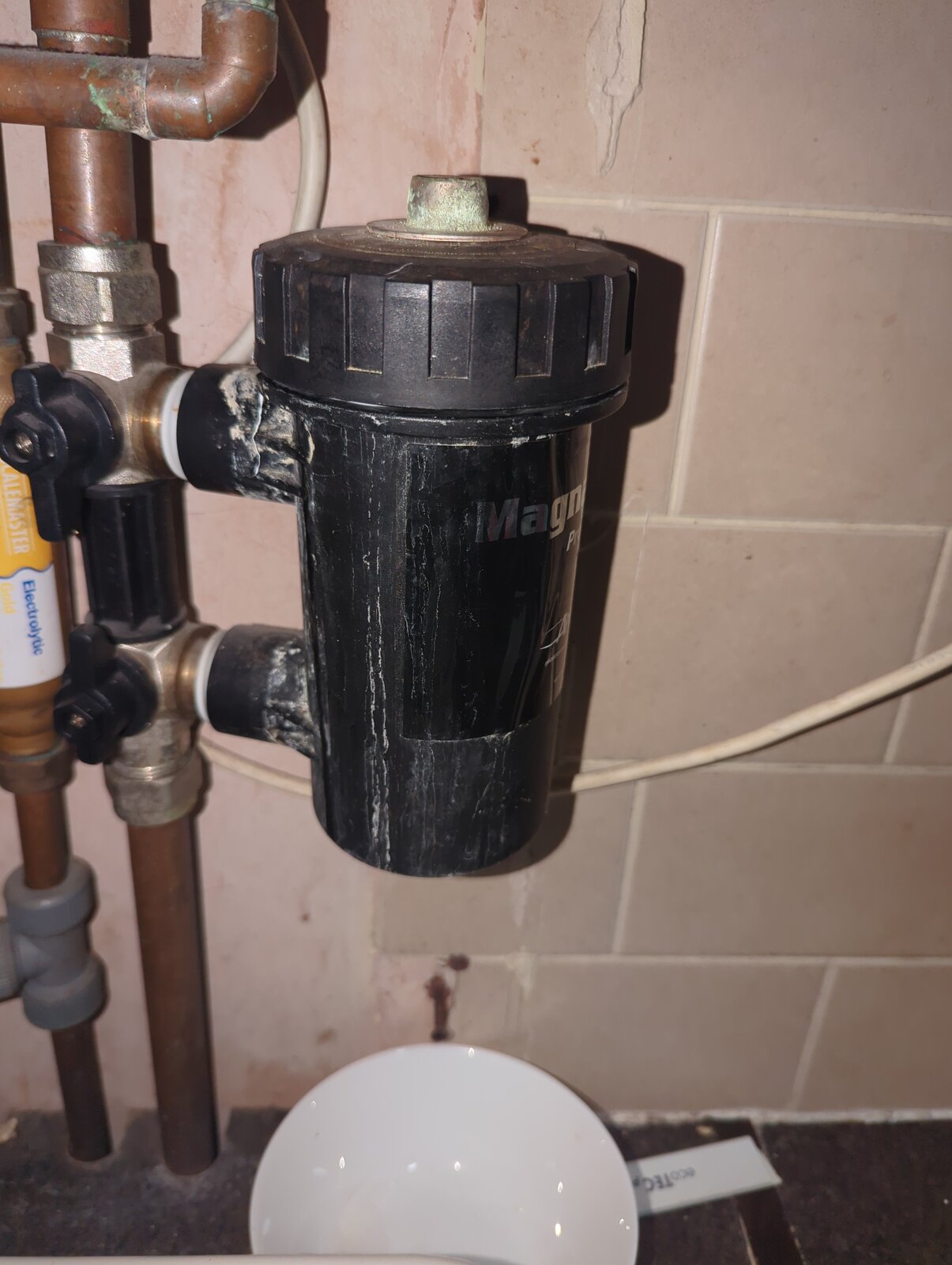

Hi peeps
I have a leak on my magna clean two it's appears to be coming from the seal I think the o ring has gone. I am looking for a plumber to come out on Thursday but until then my boiler pressure keeps dropping .
Is it safe for me to put PTFE tape around the thread to stop it leaking temporarily ????? Sorry if a silly question

Check the condition of the seals, it may just need cleaned and some silicone grease applied. These plastic fibre containers/lids can be a nightmare as the threads on the lids can jam before they tighten enough or when it comes to removing them, either that or they are overtightened, that over compresses the seal and then with expansion/contraction the seals starts to weep.
I always grease the threads lightly so they're not a nightmare when it comes to servicing.
