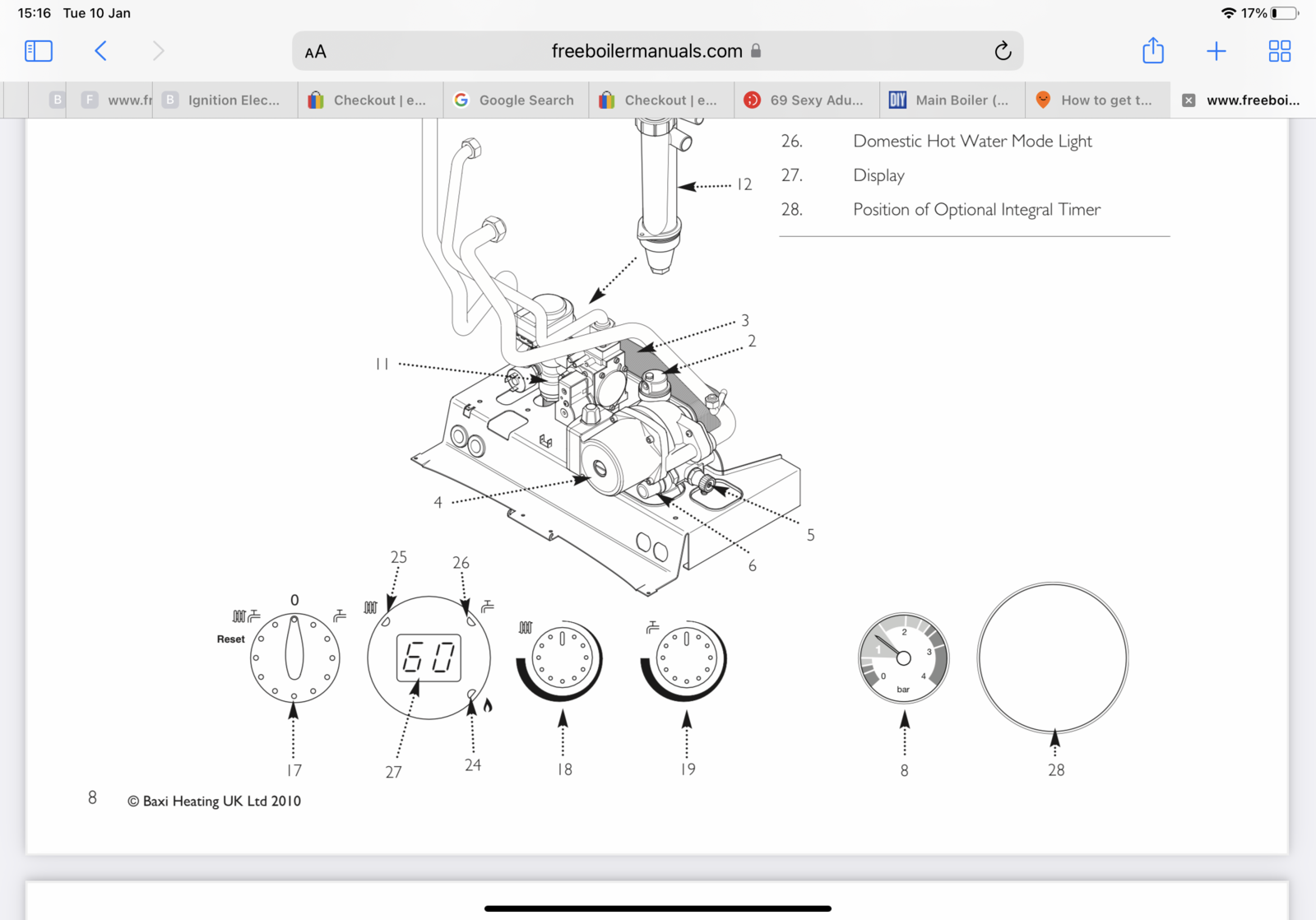

Hi folks, spent a while on these forums already but can't quite find something to suit my problem.
Main Combi Eco 30 boiler. (similar to many baxis)
Was working fine then started to have an issue with the hot water. basically when the boiler was called burner would cycle in and out rather than staying constant resulting in luke warm water at best. CH was working fine at that point.
Diverter valve seems fine as the problem happened whether or not CH flow valves were open.
I managed to solve the issue with a bodge where if i had the heating on max for a while so it was north of say 70 degrees I could use the hot water passing the HE to warm the HW as opposed to the heat from the burner. Not ideal but worked enough for a fast shower.
Now I can't even do that as the CH is now playing the same game, cycling on and off the burner while not getting north or 50 degrees (its set to 80).
I've checked the magnoclean filter and thats pretty clean, put a new thermistor on and generally spent a bunch of time trying stuff and reading up but with the CH now struggling to heat the radiators with the burner cycling in and out im thinking its new boiler time unless I can come up with a fix.
Any suggestions or advice greatly appreciated.
Thanks Ian
24, 25 and 26
For heating what lights are on and what is the number on 27
For Hot water again what lights and what number when 24 goes out.
24, 25 and 26
Hi, when heating is on 25 is lit. 24 turns on and off along with the burner. 27 shows for example 40 even though its set on a target temp of 80 and its been on for a few hours. It will usually spend around an hour cycling on and off the burner with the temp varrying between 38 and 42 to eventually push slightly higher then varrying between 40 to 44. Once it gets to 50 its doesn't seem to be able to push much higher.
For HW 26 lights as soon as the water is called. the burner light 24 again goes on and off with the burner. The temp readout doesn't move any higher (no more than a few degrees variation as above) but will quite quickly drop so lets say I have it on 50 degrees showing when the water is called it will be in the high 30s if you leave the tap running for a few minutes.
thanks
