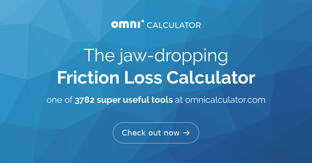

Nice calculator!
But a 7mm bore hose loses 0.8 bar? That seems very high!?
I think my current hose is longer than 1.5m as well..

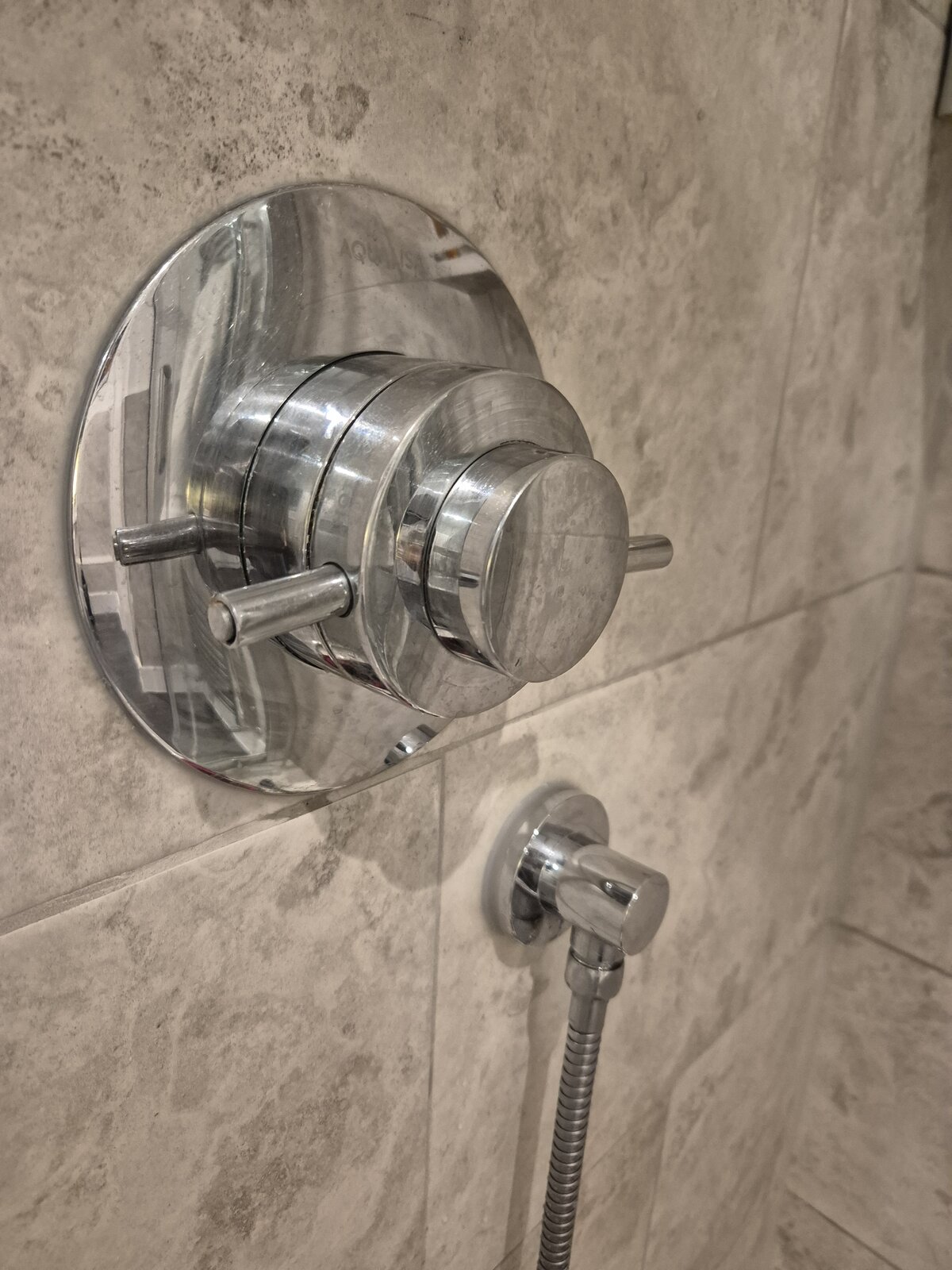

Does seem high but it'd explain why you're getting such an increase by just dropping the shower head. Would suggest you've got somewhere between 1 and 1.5 bar dynamic at the mixer. The mixer is still likely throttling the flow to balance temperature so there's a good chance you'll get a flow close to your 12 with a less restrictive head. Let us know how you get on!
Just by dropping the shower hose actually! The flow is the same with the hose, and with the hose + head. New hose arrives tomorrow. Will report back! :D
New hose!
Cold (7c)
Flow out of the new hose, no head - 13.5LPM ! (must have some measurement error)
Flow out of the new hose, with head - 12.9LPM
Hot (approx 41c, ΔT = 34c)
Test 1: Flow out of the new hose, no head - 9.6LPM
Test 2: Flow out of the new hose, no head - 10LPM

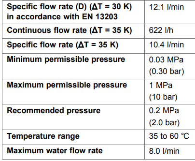

My boiler can supposedly produce 10.4LPM, so I guess this is about the best I can hope for then?

@muggles states that the boiler has a internal flow restrictor but I don't see any mention of it in the MIs, (above), no harm though to isolate the mains and remove the mains inlet to the boiler and check for any external restrictor, also check the isolating cock/valve at the boiler is fully open. Also check shower filters, if accessible,
While it won't help, maybe check the DHW flowrate, d.36, in the diagnostic parameters.
