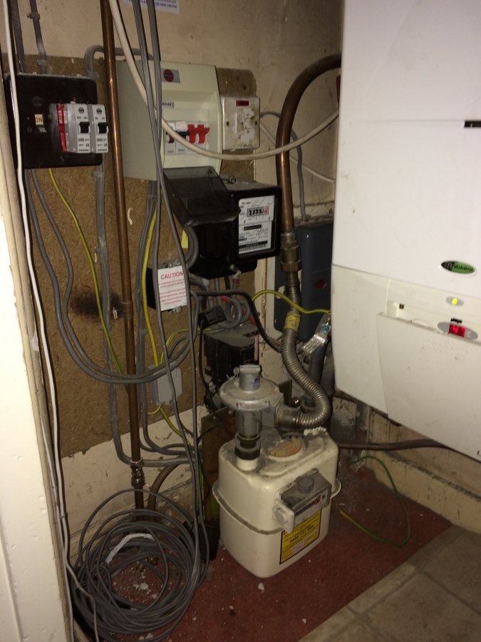

Went to look at a CU replacement for a customer today.
Hmmm

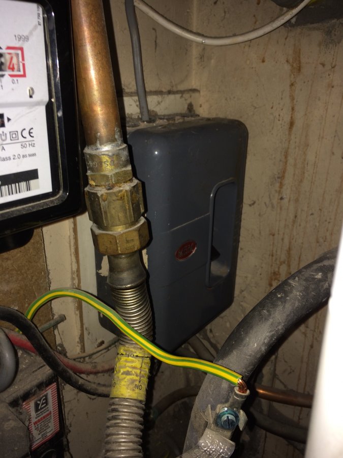

We love the gas meter in front of the cut-out!
The customers however get a shock (especially if the main fuse has blown or the cut-out damaged, when we refuse to work in the area until the gas meter is moved.
