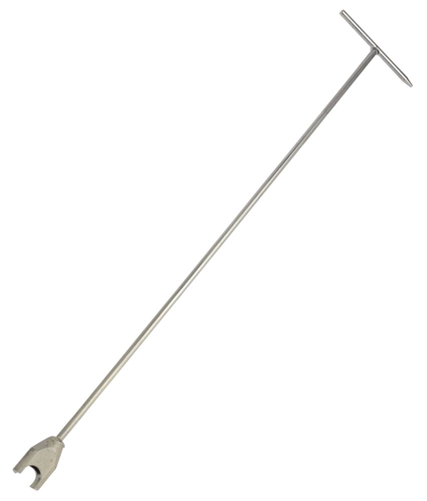

Our house was built in 1939. The main stop cock is outside the house. Which stop cock key will I need ? I removed quite a bit of soil and found that the top of the cock looks about a half inch/or three quarter inch square. Would that be the correct size for a house built at that time ?

Hi mate, if they have renewed the old water mains for plastic there should be a key with it, if not, open a neighbours water main grid and see if there is a key in that one. The new mains stop tap in the street off the ferrule has a plastic key. If its the old type you can buy a stop rod from bnq, they're about two to three feet long, have a cross bar at the top and kind of a two prong fork at the bottom. You locate the prongs over the tap head, but be careful, move it back and two a few times to loosen it. If you can turn it off, you can the replace the stop cock in the house easily. If the stop cocks have been seazed, there could be a chance that the valve seat washer has broken up and causing an obstruction this reducing flow. Hope this helps. You could go to any plumbing trade centre for a street key, probably cheaper than bnq.
Just read again, so it would appear that the tap head is missing off the street stop cock? Mmm? You may have to improvise with a tool, or try and get a self adjusting tap spanner on it they should reach but maybe a bit too big. You would have to try and find a new tap head for it from a builders/plumbers merchant.
You could get a 4 in 1 Universal Stop Cock Key, (Screwfix)
Fits 2 sizes stop Taps and 2 sizes square stops on taps.
Clean out pit, plenty of WD 40 and a bit of luck you may be able to turn it off, if not its going to be a job for the water board.

Bosswhite, Yes looks like the tool we were loaned years back when we moved in, so that we could turn the water on for the house. The outside stop cock is within our grounds and just outside the kitchen window. There has never been a handle on the outside stopcock.

that is totally wrong as well, it is your responsibility as soon as it enters your property (front garden not your house) which is why the co stoptap is placed as close to your boundary as possible, it won't be a plastic stoptap or one where some handle has fallen off, it is a square top which comes in two sizes, the multitool above is designed to fit either although in my experience it doesn't
