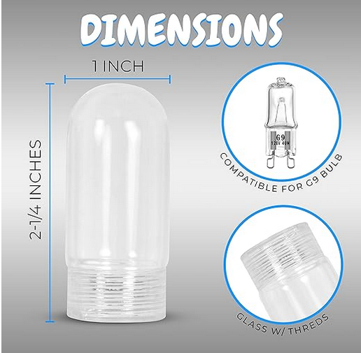

The G9 is 230 volt and not really much difference between them, the main point with both is they need a cover, 1698357763206.pngthe one shown is for a G9 bulb it does two things, one it retains the white hot quartz should the bulb explode normally caused when they blow and one gets ionisation. And the second is to stop harmful rays from the bulb.

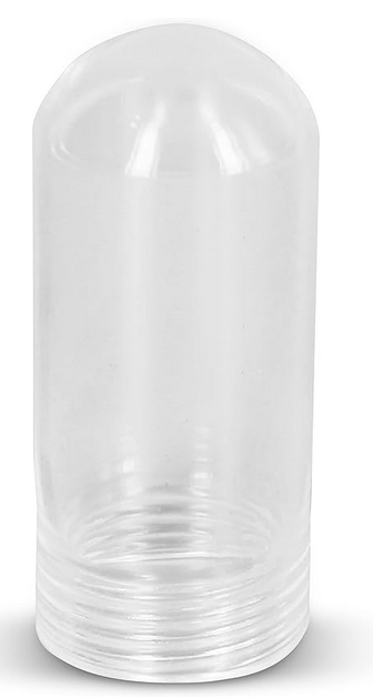

Same with G4 1698358069968.png these covers mean it is near impossible to get a LED replacement which will both fit inside the cover and will work with any electronic switch that does not use a neutral.
