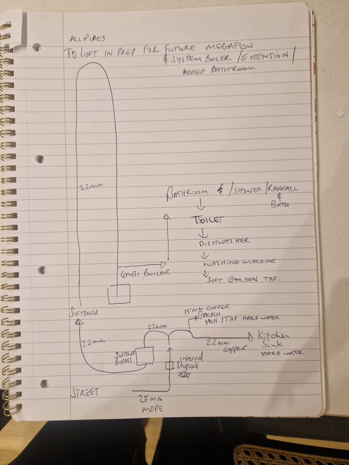

Setup is as so:
MDPE in 25mm to mains stopcock
That splits immediately to an isolator then runs to softener which runs to my bathrooms up and down, toilets, kitchen sink for hot, dishwasher, washing machine etc. (the softener is currently bypassed so not active- it is a HF softener however with 22mm pipes)
The other split from the MDPE in goes to my kitchen sink for hard water and nowhere else.
I have a feeling my outside tap tees off from the soft that goes to my dishwasher

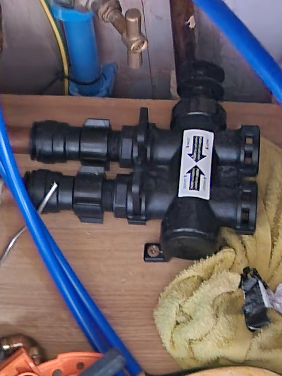

A photo of a quick pencil diagram might have been better/easier to follow, but it sounds as if the problem might be at your softener bypass. Double check it is fully open, if it is, take it out and make sure the washer is not breaking up, partially obstructing the flow, and that it allows full flow diameter.
Will take a look, it's this style bypass
Diagram attached. The bypass seems to be okay (though may not be internally)
I have now got two garden taps (one soft and one hard as in drawing)
