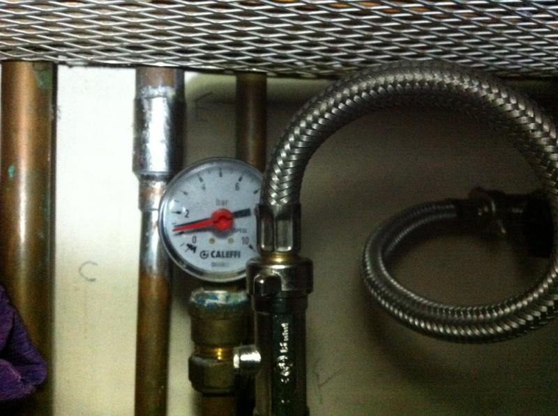

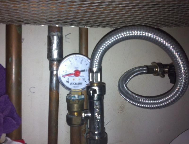

I've attached a photo, of a few pipes, and a gage which is in the airing cupboard, this gage does not move, and there is a little stop/start switch to the right hand side, i've turned that on/off, and still no difference.
Please Help!! :-)
There does seem to be some pressure in it.
In a loft you only need about 0.6 Bar.
But I am not convinced its a pressure problem but as you have not said what boiler you have I cannot assess the possibilities.

if the hot is ok elsewhere i would suggest you are getting a backflow from the shower valve.
Pressure fine according to the gauge.

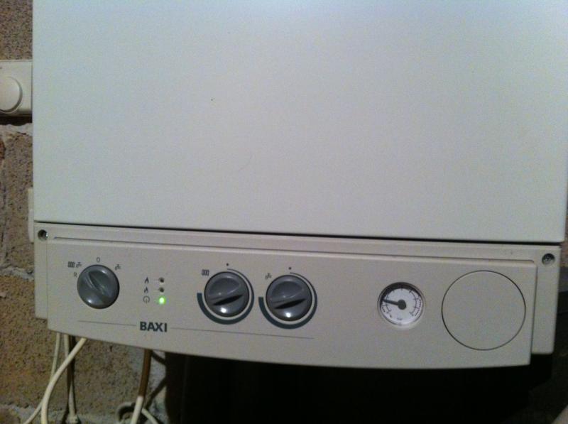

Why not nip up the ladder and id the boiler?
Tony
Looks like pre 2005 from what can be seen.
Deff somthing wrong!
Tony
Here'a a pic!
You don't need two posts, your just confusing people.
Your system pressure has nothing to do with your shower problem.
