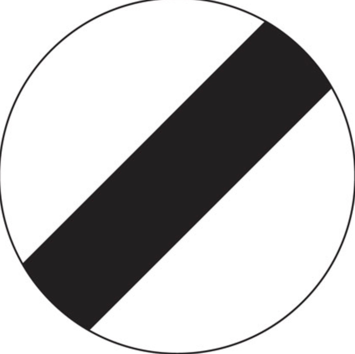

What about banging an oblong(ish) piece of 38mm wood in the hole so that the point of a 40mm spade bit can start in the centre? Something like this:
