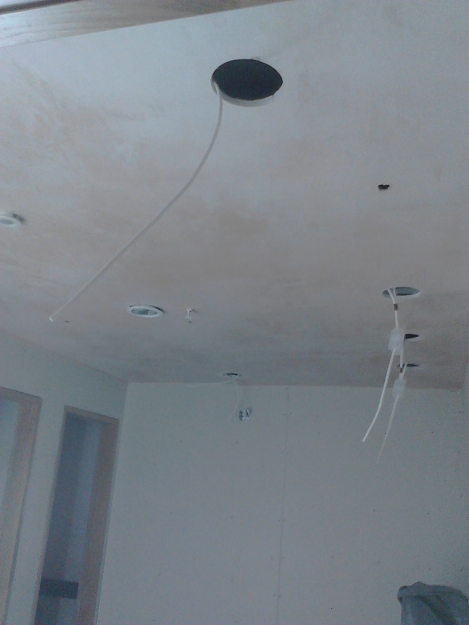

id dearly love to present my plasterer with a clear ceiling/wall without any wires hanging out of it that he has to work around. He's also said its easier if I don't drill holes either, but then I have he awkward job of finding cables and not damaging them. I'd like to know if there's a reliable way to leave small holes, push the wires inside but in a way where they both a) won't drop inside the wall and b) won't foul his trowel. He can skim right over the hole for all I care and then I'll break the skim off afterwards. Same for light switches etc, because here drywall boxes I'd like to mount them first because of the lip, then maybe scrim over the whole thing, then he can plaster over it and I can cut the skim out after?
what's e best way?

That's rubbish him telling you not to drill holes , go ahead and drill them then push wires up fold them in 2 and push them up so they are not protruding they will stay put until pulled down again the holes don't make any diff look in my album you will see a lid there with lots of holes in I done

Standard practice as well to get the holes and wires sorted
depends on the size of the holes, nothing worse than plastering a ceiling with hole cut for down lighters and dollops of plaster fall out into your eye. All the sparks I work with have a simple rule. If the able is clipped to the joist pull it through the board if it doesn't, then tack over it and the sparks keep a map of where the holes will be cut after the plastering.

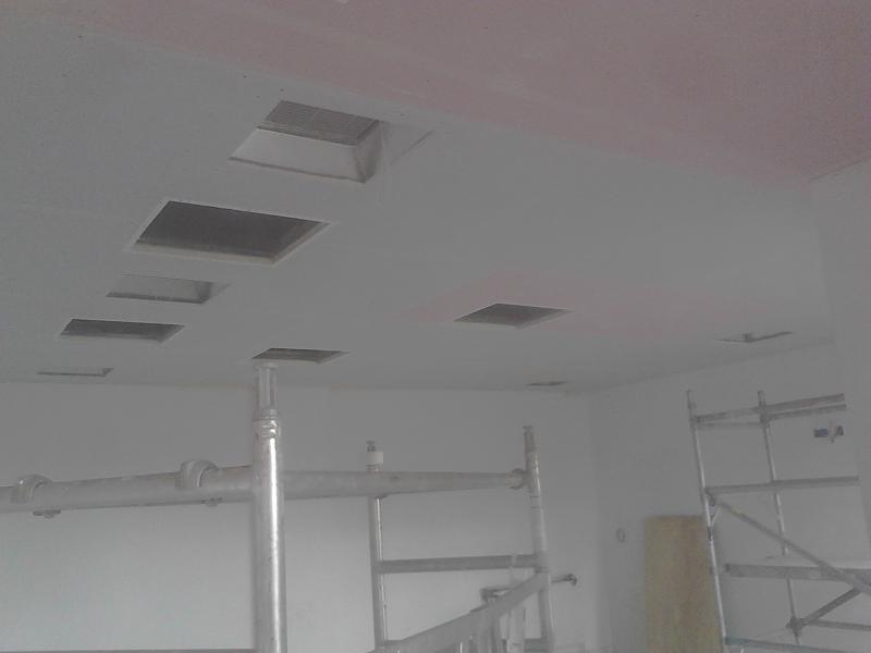

Well as I said in post its awkward for some mainly people who are not experienced and tbh holes don't make a blind bit of difference to a good spread and yes I've had plaster in eye but not from holes, holes are so easy , and your saying its unnecessary? All the lids I've skimmed and its hundreds ,the holes and wires were done first that's the way the contractors do it you can't have someone going over a 100m2 lid looking for say 30 wires and making holes after its been skimmed the only holes I ever find a pain is access hatches with frames on like this as you have to skim round em and espec when you have about 10 in one lid but normal holes? Let's get back to the point because no ones missing any point the op was told not to make any holes if I ever heard a spread say they would cause him trouble then I wouldn't employ him because it would show his inexperience
