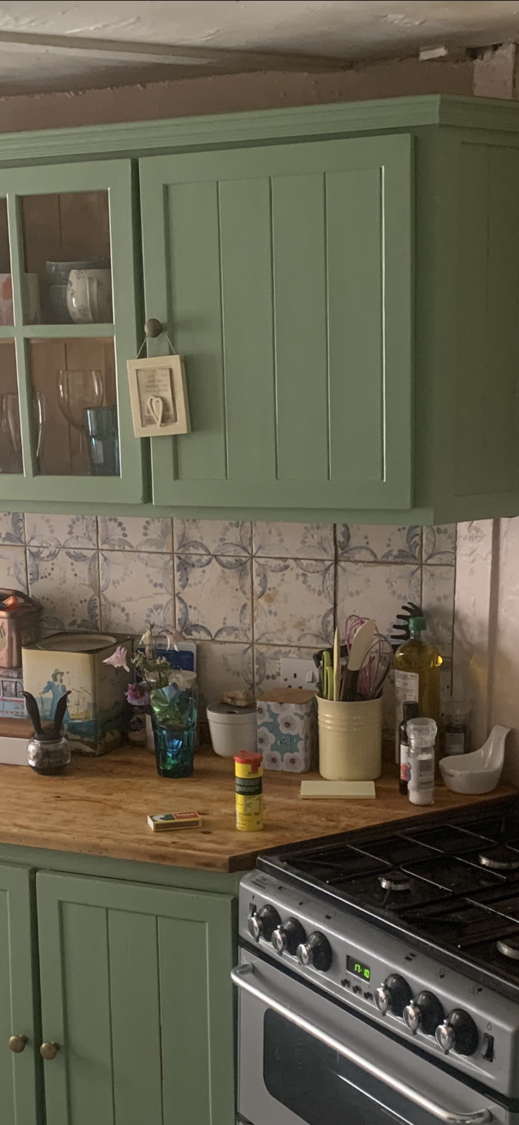

I need some help from any carpentry experts on here.
I want to try and build a couple of extra units in an old kitchen that predates (comfortably) the likes of Howdens etc with the carcasses and fronts all made of pine.
I would like to give this a try myself and need some direction on (a) the actual carcass build - links to any useful guides / videos, and (b) where could I source the fascia board (if that’s even the right word?) for the front panels to match?
Any help or tips much appreciated.
Jem
i had to make some side panels to a 2007 MFI kitchen and used a router to make them.
And made doors with T&E effect , along with a shaker style Toilet Cabinet and matching on part of the wall
Have a look at Peter Millard on youtube, he has some videos on making cabinet carcass and shaker style doors
Cabinet Basics series
Maybe use Moisture Resistant MDF or some pine V groove T&E cladding
What size is the gap between the groves and how thick are the door panel and in total
If it was me, I'd buy some 9mm grooved MDF (e.g. but you prob don't need a full sheet) https://www.travisperkins.co.uk/mdf...oved-mdf-panel-2440mm-x-1215mm-x-9mm/p/378622 and some 9mm ungrooved MDF. Cut the ungrooved into strips and lay on as a frame around the grooved (cut to full size). Securely glue it all together, round off the sharp edges slightly, to make an 18mm thick door. There will be some gaps along top/bottom where the grooves show - some 2 pack filler will sort that. Prime, paint, job jobbied.
For the carcasses you can buy 18mm faced MDF/Chipboard to make up the sections, and then dowel/biscuit/screw together. The hardest thing is to cut a straight, chip-free edge where it shows - a track saw is the best tool, but expensive for a one-off - you would be better going to B&Q and buying an off the shelf carcase. They are cheap as chips, and perfectly serviceable.
