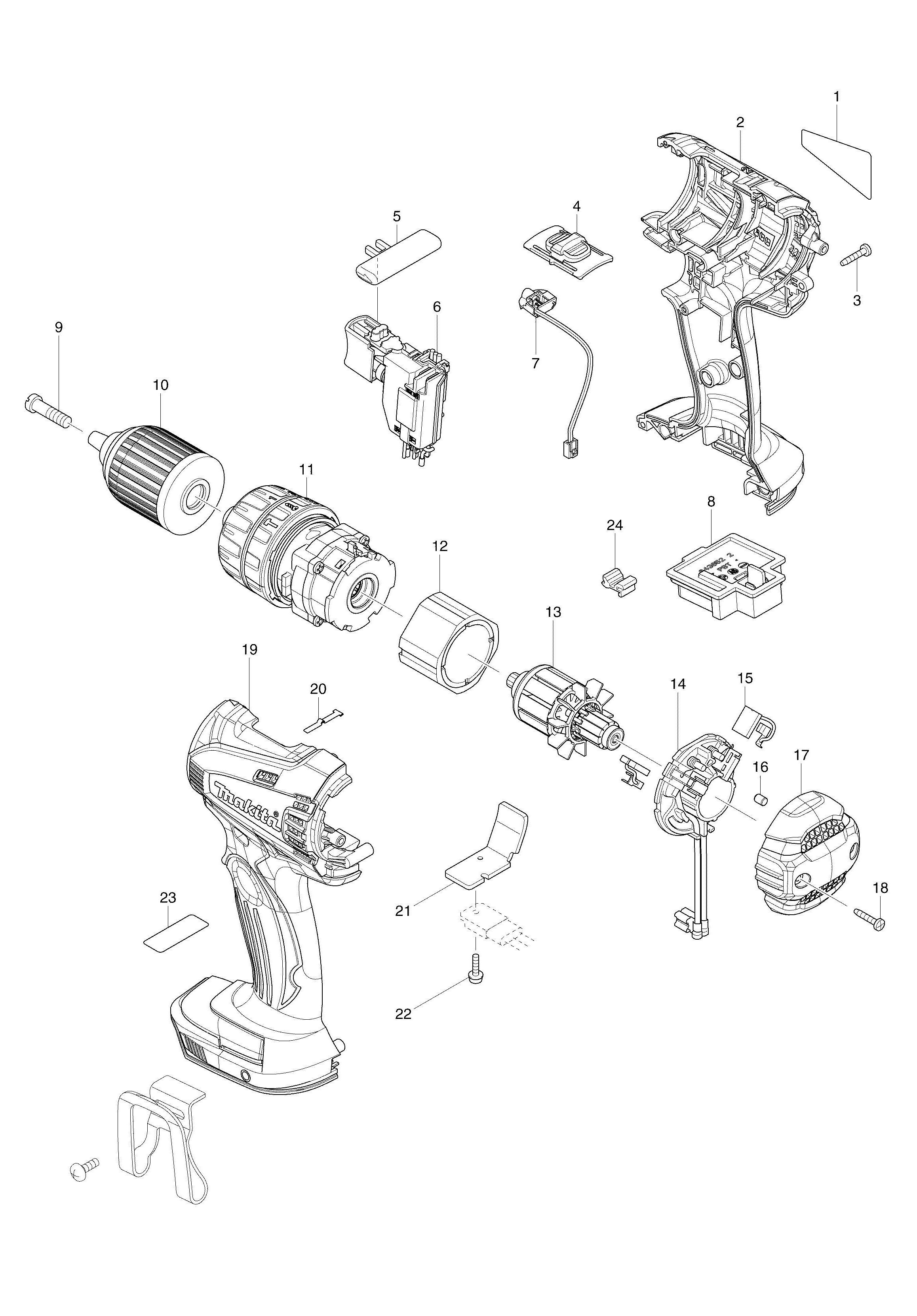

My Makita BHP 456 cordless hammer drill,
I am unable to remove the battery,
could this be a catch or latch that holds battery in place has broken ?
Is there a way to remove this by stripping ?
unable to find diagrams.
