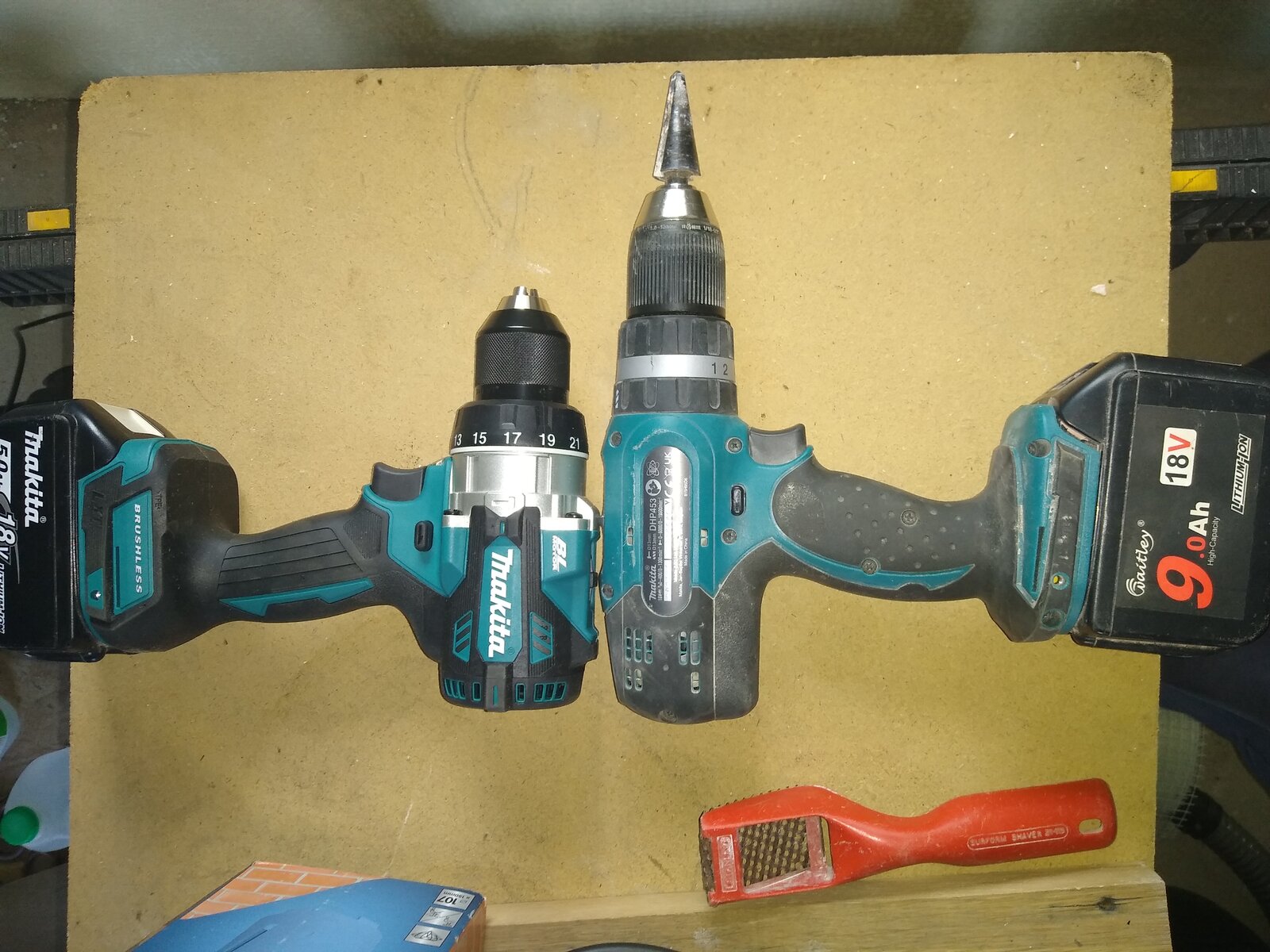

I can't believe how small it is compared to a Dhp453 IMG_20220224_101342538.jpg
They'll be like chalk and cheese - the 453 can't pull the skin off a rice pudding! The 481, in comparison, is a bit of a beast, but heavy...
The dhp458 is brushed but powerful enough for boring mortices for door locks, or bolts in beams in gear 1. It's top speed will drive in screws very quickly, although it is on the heavy side so best used with an impact driver for fast repetitive screwdriving. They were going for £50 bare a few years back, I suspect they were being phased out in anticipation of the brushless 481 then being introduced, but are selling well and the price has gone back up, still good value though.

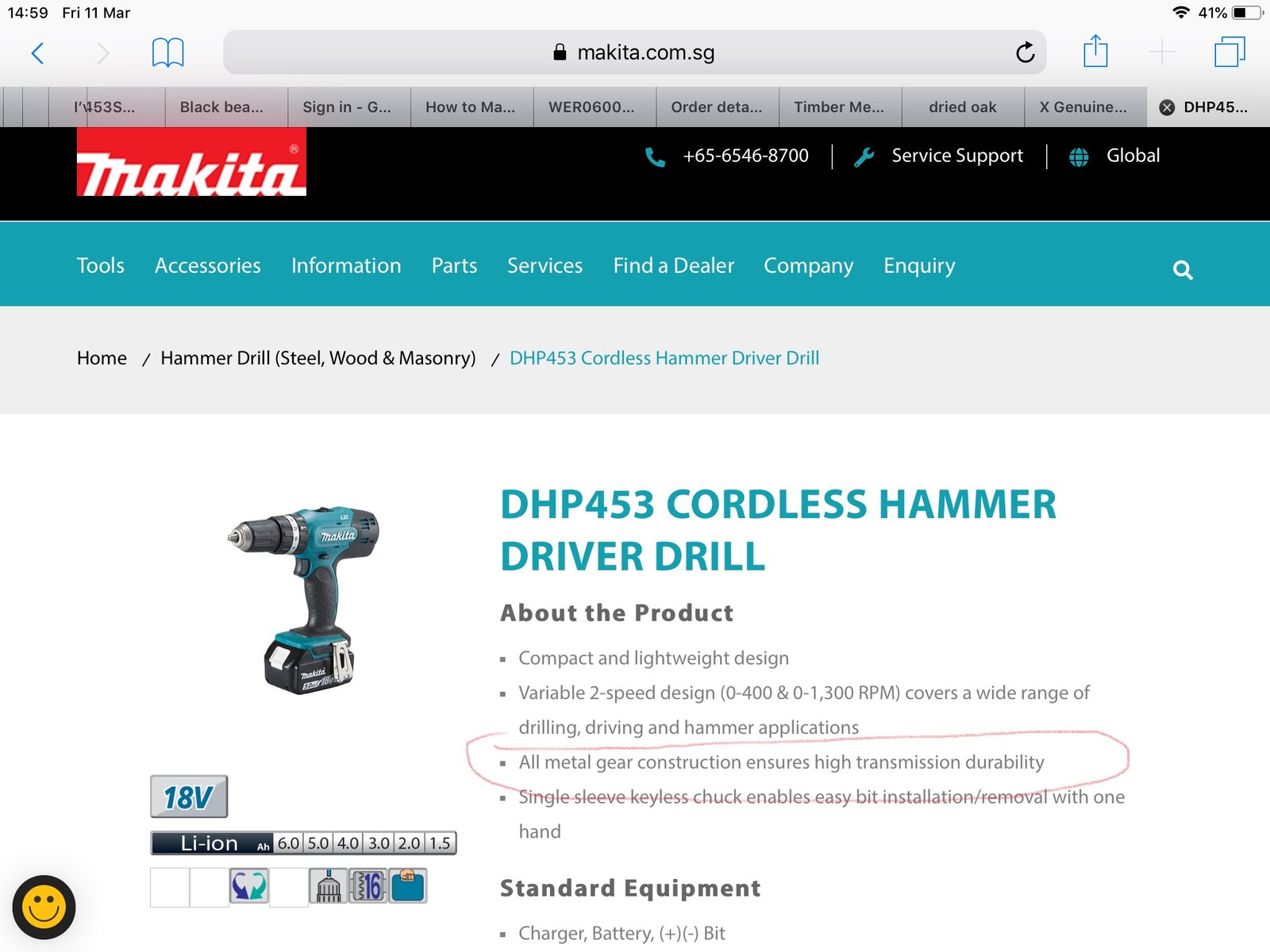

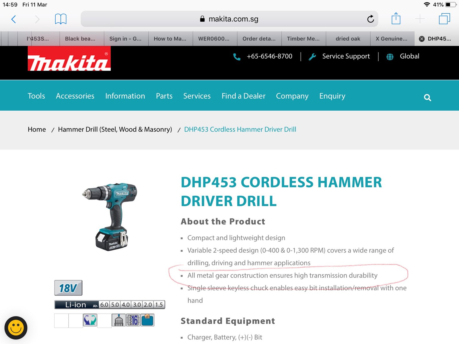

A few years back there was a guy on another forum, just out of his apprenticeship, who was complaining bitterly about how crap Makita combi drills were and how he and his mates were always breaking them. He eventually admitted that they were drilling into brickwork to fix door frames, on a price - using DHP453s. He took a bit of persuading that a drill which cost all of £28 (or thereabouts at the time) might not be designed for the task he was doing and if he was any sort of serious tradesman he'd buy himself an SDS drill or a DHP458 combi at the very least to do the job (there are other drills in between as well).
There is nothing wrong with the 453 providing you bear in mind that it has a relatively low power motor, a plastic gearbox casing and nylon gear wheels - so it's designed for light use (basic DIY, handyman, flat pack assembly, etc) and not as a heavy site tool which will be constantly hammered. But surely the price point should indicate this?
Screwfix do offers from time to time on the 453 and it is cheaper to keep the batteries and sell the drill, charger and case, than buy the batteries new.
The 453 is a good diy/light trade drill if you are putting in red plugs and 4x40mm screws.
Blup
They (DHP453) are the lowest spec brushed motor and have nylon gears. Good little drill for handyman stuff, but not really up to heavy work.
Quite a few years ago I had a DHP452, the next model up - basically slightly smaller, slightly more powerful. It was good enough for a lot of jobs, but it couldn't drill anything other than soft blockwork or soft brickwork and it wasn't good with auger bits over about 16mm (the same goes for any low end drill from any manufacturer - they have their limitations). My DHP452 was displaced by a heavier drill after about 3 years of sustained use and gifted to my apprentice at the time who had no drill of his own. Still in use 2 years later when he bought a new kit.it, too, has nylon gears, but the lad took the advice of several of us to buy an SDS drill for masonry
