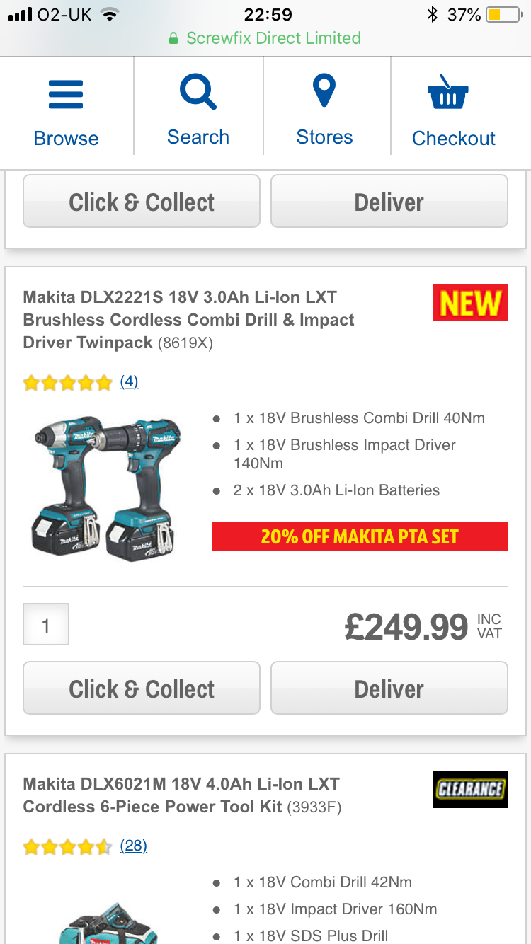

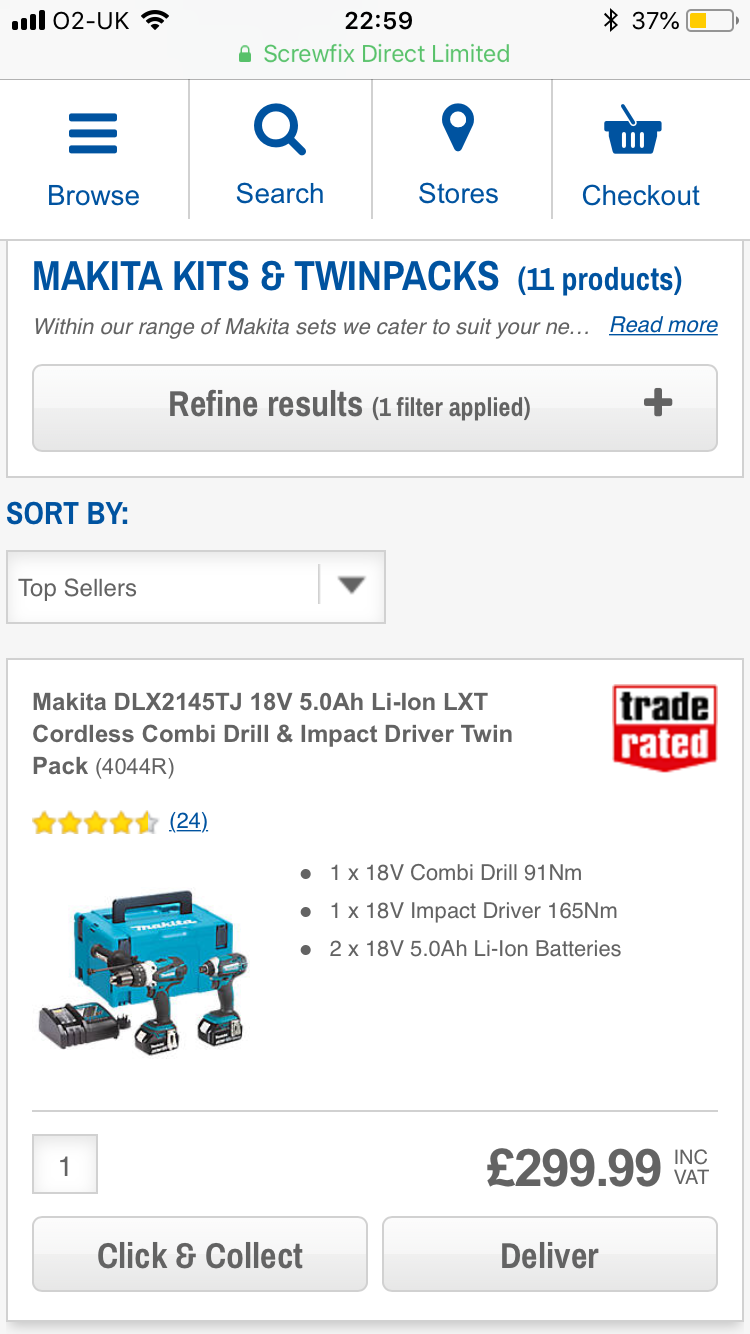

After some knowledgable advise please.
I’m looking to buy a new drill set and have decided on Makita. The brushed set is more expensive than the brushless probably because of the batteries but it also states a greater Nm force than the brushless.
What’s a better set in terms of power?
Thanks.

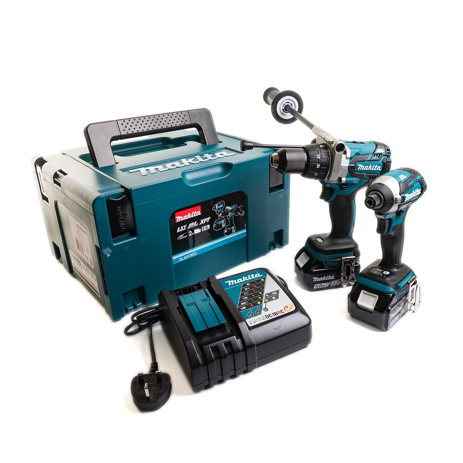

Brushless is best but the two brushless you've posted aren't comparable to the brushed kit in terms of power. These brushless are marketed as subcompact tools.
I have the brushless drill from that kit and while it's brilliant it's not a heavy duty all rounder. I wouldn't use it if I were using large forstner bits or drilling steelwork all day.
A comparable brushless kit would be the DLX2176TJ, at around the £400-450 price a lot more expensive but will out perform those brushed all day long.
I have the brushless kit (only with the DTD129, the older model driver) and I have had the drill from the brushed kit side by side. The bursbed managed a week before it was on eBay. Just doesn't compare to the DHP481 at all.
Now deciding which you need is entirely down to what you're doing. DIYer, brushed will be fine, in a trade and using it all day every day? Brushless.
I actually have three brushless drills that come to work with me, the one from the kkt you posted, the one from the kit I posted and the 10.8v drill Makita do.

Thanks for the reply Sammy. I’d ony ever use them for DIY and know there’s a better brushless kit on the market. I suppose I’m mainly going by price and the main think that’s got me thinking is do I forfeit the brushless to have more power in the brushed?
Again I'd probably still go with the brushless but as a DIYer the Brushed option will give you a greater scope of work as those are beefier and have larger batteries.
So yeah, in your case probably the brushed kit would be better suited.

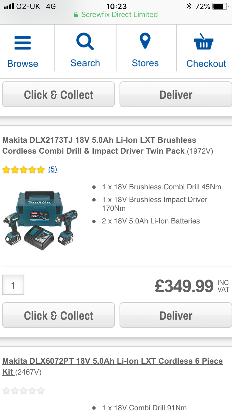

Seams brushless is obviously better maybe I should just go all out and get this kit?
I’m quite keen on having more torque on the tools, ideally want to get a really good set that will basically last me DIYing for many years to come!

I'd definitely go brushless if the budget is there but word of advice, shop around. Screwfix normally has a very high price compared to others.
FFX are usually quite reasonable.
For a DIYer, you really are going all out on spending!! There's plenty of tradespeople who wouldn't spend that much!
You really don't need the larger capacity batteries for DIY use, buying a set with, say, 2 * 2.0Ah batteries and buying a third 2.0Ah battery separately to go with it would be a much better idea IMHO. The tools will then be lighter, so more comfortable to use and you've always got the third battery on charge ready for when one goes flat. Charging the flat one and trying to use both drills by swapping a single battery between them becomes very annoying, very quickly!! :mad::LOL:

Cheers for the reply. The key thing I really want is good torque especially on the impact as I hope to use that on an old project car so want a bit of beef behind it. Then I think I may aswell go brushless then it all spirals out of control and I’m looking at spending £350
i dont think the impact will be much use on a car as its 6mm drive and quite soft on impact
you need a heavy 1/2" drive
i could off course be miles out but breaking the bond on metals is several levels above screws or fixings in wood
