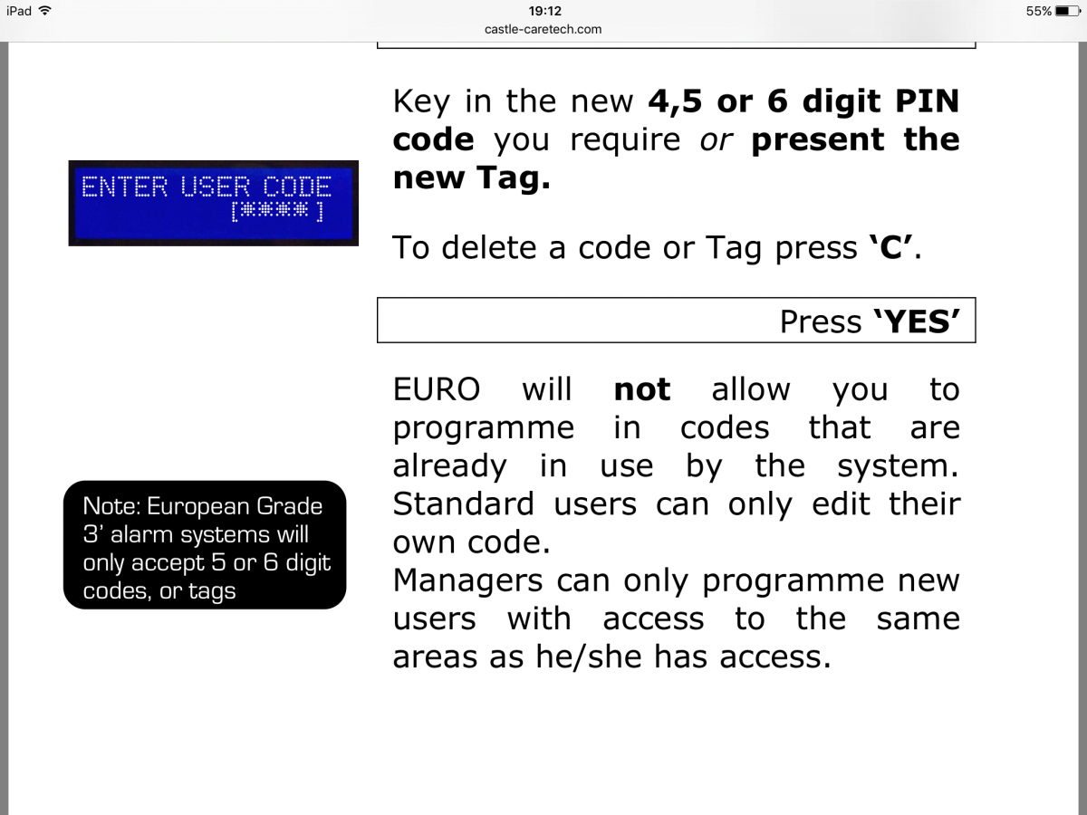

Hi - when I pres D and my user code I get access to the settings menu. When I get to the Managers code reset, it shows a field with stars. when I press yes to change it and enter a new number, the A B C D keys all light up red.

If you can get to change the manager code , your code is the manager code
When I get to the manager code, it is 6 stars, but my user code is 4 digits. Does the 6 stars mean the manager code has 6 digits? If it is, I don't think if it is anything we set.
I can be ....
Thank you for your patience! I am going to run through the menu again - it just threw me that it showed 6 stars- I thought this meant the current code was 6 digits.
