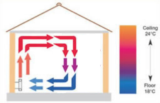

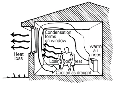

I think more due to the large slewing range, a mechanical TRV has a slewing range of around 3°C, i.e. difference between fully open and fully closed, the position may not be prefect, you want to measure the return air, and the radiator causes a thermal circulation, simple like this circulation3.jpg however in real terms items like windows can change it a bit circulation2.jpg this is why as a compromise the wall thermostat was placed on the wall facing the radiator being in the thermal flow but as far from the radiator as practical, the Myson fan assisted radiator worked very well due to the forced circulation, however it is not always good to have whole room at the same temperature, some times it is better to allow pockets of warm or cool air, either where sun shines through a window, or window loses more heat than walls, I lived in a house with hot air central heating before the days of double glazing, and whole house even heat, but heat losses were high so expensive to run.

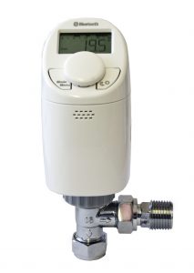

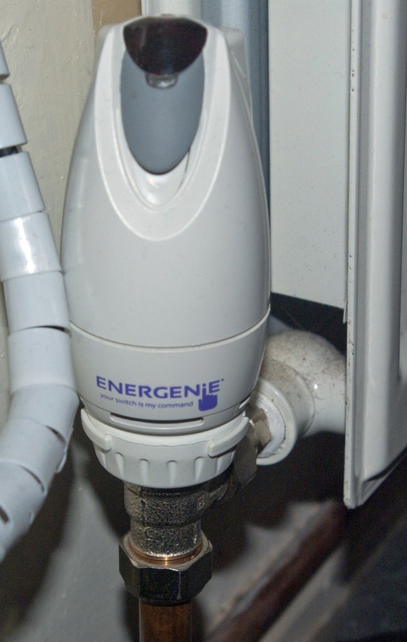

The first electronic TRV head I got, IMGP8035.jpg had two sensors, one for water and one for air, and the water one compensated for the direct heat from the radiator, however the built in anti-hysteresis software was a bit OTT, so in the morning set to 22°C for one hour then down to 20°C to counter the OTT anti-hysteresis software, and once the lock shield was set except for where morning sun caused a problem with slight overheating they were spot on, however expensive, the second type I got were far cheaper, EQ3-Straight-213x300.jpg no wifi, although did have bluetooth, so either you can adjust with phone or link to another head so if two radiators in the same room they can work together.
I got the first type as told they would work with Nest, however when Nest was bought out by Google the support was dropped, so only option now with Nest is set the same schedule. We are told the Drayton Wiser TRV heads like the Nest wall thermostat works out how long it takes to heat a room, so the problem I had with OTT anti-hysteresis software is avoided.
However all these clever algorithms depend on things like doors being always the same, in spite of the EQ3-Straight-213x300.jpg being cheap, it actually has a window open detect to turn off the heating in the room for a settable time, should a rapid temperature drop be detected, I have the one in kitchen set like that so it switches off while we unload to car and have back door open.

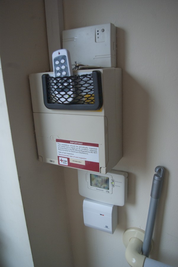

Mothers old house two wireless thermostats in parallel IMGP8038.jpg one receiver above consumer unit and one below it, trying to keep some distance between the two with EMC in mind. So one thermostat in kitchen and one in hall, neither ideal positions, but as a pair they worked well.
