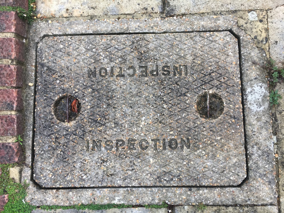

Manhole cover replacement
29 May 2017
2
Is it the concrete rings or bricks inside?
You might have to reduce it lower down then fit a normal sized lid on.
Open it and post a photo and measure the depth from finished paving surface to the base of the pipe at the bottom of the chamber.
You can often reduce the opening to allow a 600x600 cover to be used but not if its too deep. Sometimes those old conc chambers dont even have a junction in them, its simply an inspection point so less critical.
