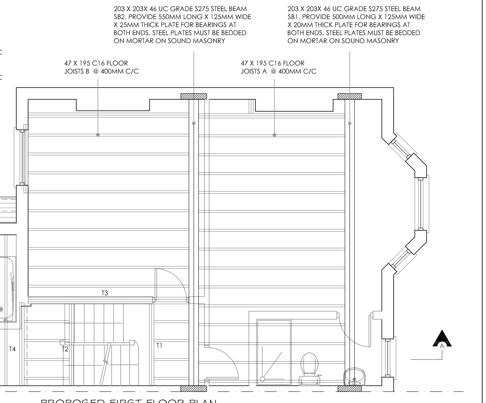

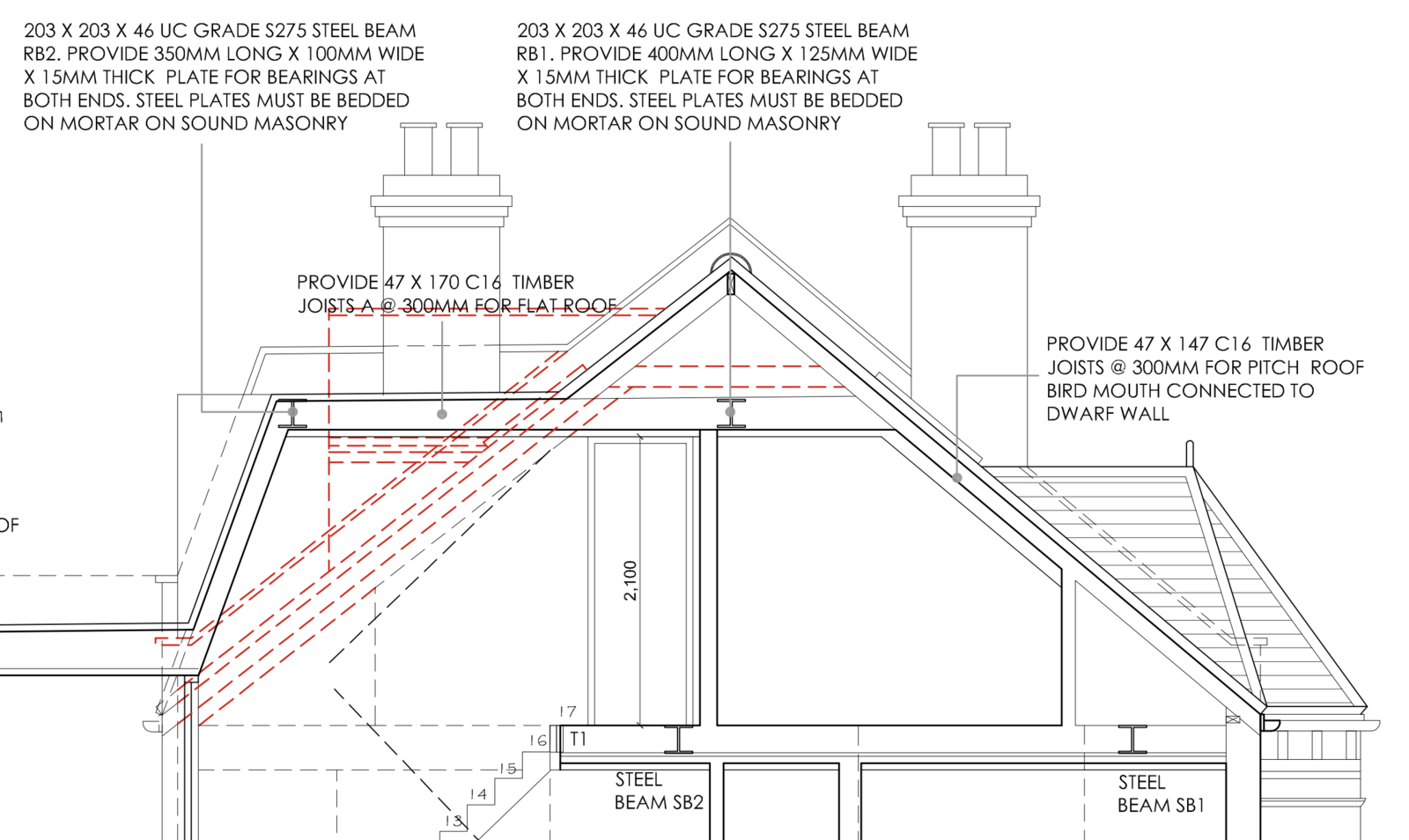

We have a standard semi detached Victorian home. We are converting our existing loft with small dormer to a full size mansard.
To do this we are being asked to put in 4 steels. 2 above the existing floor, 2 in the ceiling. Because the existing floor joists runs the wrong way, we are being told to put the beams on top of the existing floor. Which loses us about 220mm in height. Worse it means the existing bathroom,
Which is on the eaves side is pushed up and becomes smaller than it is now.
Is there a way to avoid raising the floor. Such as flitch plating the existing joists? I asked the architect, he said the only way was steel beams on top. I just want to make sure I’m getting accurate advice for peace of mind.
Will the steels be under the loft room walls so not really affecting the floor height?
I've attached the two relevant parts, from the diagram the architect provided. The first shows the side profile and the four steels. The diagram shows the steels in the existing floor (not raising any height). The builders say the diagram is wrong, the existing joists go the wrong way, so the steels must be placed on top. So they simply moved the steels up, on top of the existing floor, significantly raising the floor height and reducing the space of the existing bathroom. The second shows the the above view of the two steels on the floor.
I did ring the Architect and he said to do the same thing. A friend, who is not an architect, mentioned that we could have possible strengthened all the existing joists with fletch plates, rather than having steels and raising the floor. So I'm just looking to make sure we have done the right thing, and there really was no credible other alternative.

SB1 could be 300mm tall and wouldn’t affect the floor if you used hangers for the joists.
SB2 is the awkward one. Even if it were directly under the wall above it I guess it would pass through a doorway or 2 at some point.
I’m no expert but looking at that the only thing I would be thinking was to move SB2 as far to the rear (left on pic) as possible. We had steels front and back then the joists were supported in the centre off a load bearing wall.
First of all I would ask the architect to make sure the drawings show existing joists are shown spanning in the correct dimension and then consult a structural engineer on the proposed steelwork and structural aspects.

I think in essence what they are saying is, they thought steels may already be there - but they did not know. Our builder confirmed there is no steels, instead there are 2.5x7 inch joists running 13 apart, and some are doubled up. Running from the front wall to the back wall, with some resting on a wall half way between. We had a 30 year old loft conversion here from before, I guess they changed over the old loft joists to those 2.5x7 to support the new floor weight. Although I’m also now wondering what was wrong with the old floor, those timber beams look much bigger and stronger than the new ones put in. Just it uses a brick wall to lay on, instead of a steel.
Anyway the builders steels cannot be placed there, as in the diagram, as those joists run front to back, instead of side to side. i.e. the steels would have to cut through all the existing joists. So instead the builder has had to place the steels on top of the old joists and I’m losing around 250mm in head height :(

Possibly ask the engineer and architect - first of all, if it is already a loft floor ,and the proposed alterations are what you call a mansard , why is steelwork required to strengthen the loft floor, and if it really is necessary would it be better to position it under the loft floor joists as downstand beams to the first floor ceiling (I know some people don't like boxed out beams at ceiling level :!:) Also why are the proposed roof timbers at 300mm centres ,they are not usually spaced as close together as that :!:
