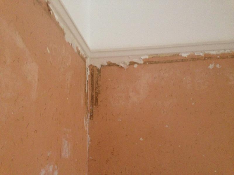

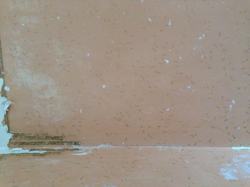

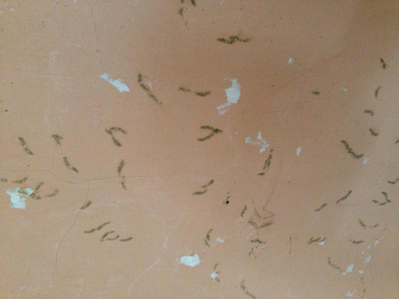

We have just moved into a 1930s semi. Started redecoration project with stripping wallpaper in rear bedroom facing garden. We notice the walls underneath have been skimmed. But we also noticed small black marks spread across the walls, images attached, what are these? Are they serious? Do we need to treat the wall somehow? What should we do? Any comment and help would be much appreciated. Thanks.

very curious marks.

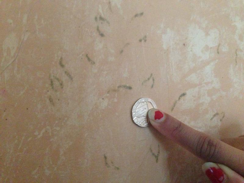

But include a coin in the photo to give it scale.
Indeed - very odd.
Almost like some sort of ivy or creeper had been growing and had stuck itself to the plaster.
Any more pictures, and as JohnD says, some idea of scale would help. Is this all over a wall, high or low down, stuff like that...
Is picture 2 a wall/ceiling junction ?
Had a discussion about similar marks the other week, put it down to old wallpaper had made these.
And remember similar when removing wood chip years ago.
I've seen those tiny black thunder bugs under wallpaper before, maybe it's those but died long time ago?
I dunno..
Just marks off the old wood chip. Be on the safe side and coat the wall with Gardz.
I think it's the print from an old wallpaper too.
You can also see the marks where an old fashioned border was as well.
Sparkwright is correct, the old wallpaper will have made these marks, seen them mant times before, they can bleed through to new paper so will need sealing first. The gold print on some of the old papers were activated by the paste.
