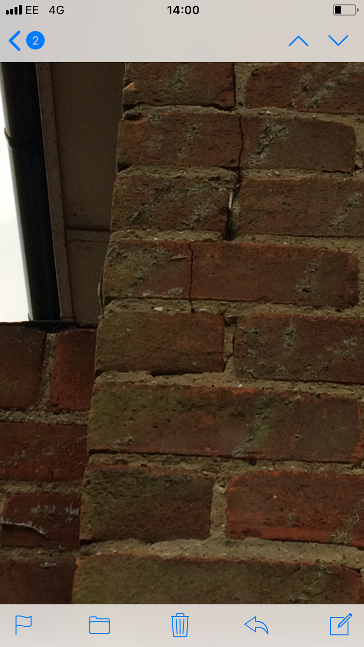

I’ve just added a couple of photos. I think a high proportion of the make up is fairly soft with a little bit of quite course sand but this on close inspection appears to be only white. Any idea? If I got the bricky to lay with a standard modern mix, would it be add much to the overall cost if it were then pointed up in a gauged mortar?
Re-pointing normally around £30 per metre but probably more in London. You could put a sample of mortar in acid which would leave you with a sample of the sand. Use the sand to build the extension and allow for it to weather in. You do pay a fair bit of cash for a mortar analysis and the mortar made up to match.
I've found that adding a bit of black helps matching older mortar, but I've only done it for small patches. New mortar seems to match in better if it's a bit darker than the original.
I doubt if anyone added sharp sand to the mix. When the joints are first rubbed up with a metal tool it covers the joint with a thin film of cement. After a number of years the weather takes this off and exposes the aggregate which is what you now see. Even building sand contains a number of larger particles, but unlike sharp sand they tend to be rounded.
