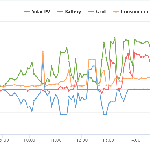

As to waiting until 10 am for first cup of coffee, forget that. But as it stands 3.7 kWh exported today, this grid today
shows how I have exported energy which it would have been better if I had used. But 38 - 9 = 29 p a unit wasted by exporting. Seems unlikely I will export enough to make using more to heat water worth while.
