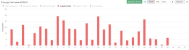

There is however a benefit in heating more water when using solar, as one may not have solar every day, however when I don't have enough solar it is clear to see, 1724886079683.pngand it is rare in the summer, replacing the immersion heater for a longer one, or using a simple timer instead of the iboost+ and using off peak would be far cheaper to running cables to control the boiler with tank temperature, so no point.
