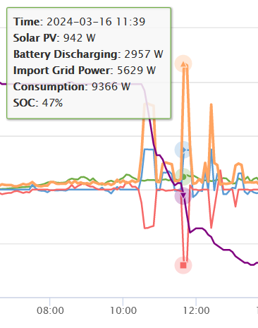

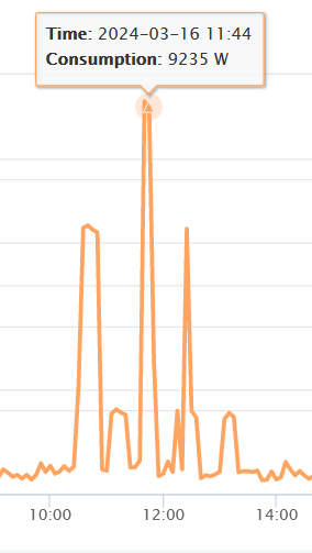

I can't see how much electric is being used until we stop using central heating. The picture was from last year, but it seems electric may be cheaper than using the central heating boiler, has anyone actually measured the two? Or is it just an assumption that electric costs more than gas so it must be cheaper to heat DHW by gas?

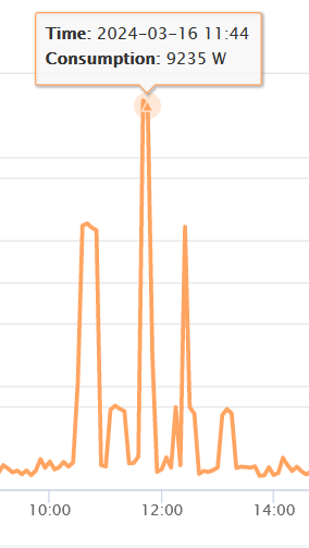

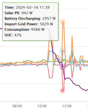

If I look at my consumption when using a shower 1711803805578.png it is very short lived, add all the data 1711803927835.png and the shower was only using 5.6 kW from the grid, so the cost is likely 60p for a 20 minute shower, to switch to a hot/cold supply shower will likely cost £200 plus, even DIY, so at 73 it will never pay to change to hot/cold supply type.

If I look at my consumption when using a shower View attachment 338589 it is very short lived, add all the data View attachment 338591 and the shower was only using 5.6 kW from the grid, so the cost is likely 60p for a 20 minute shower, to switch to a hot/cold supply shower will likely cost £200 plus, even DIY, so at 73 it will never pay to change to hot/cold supply type.

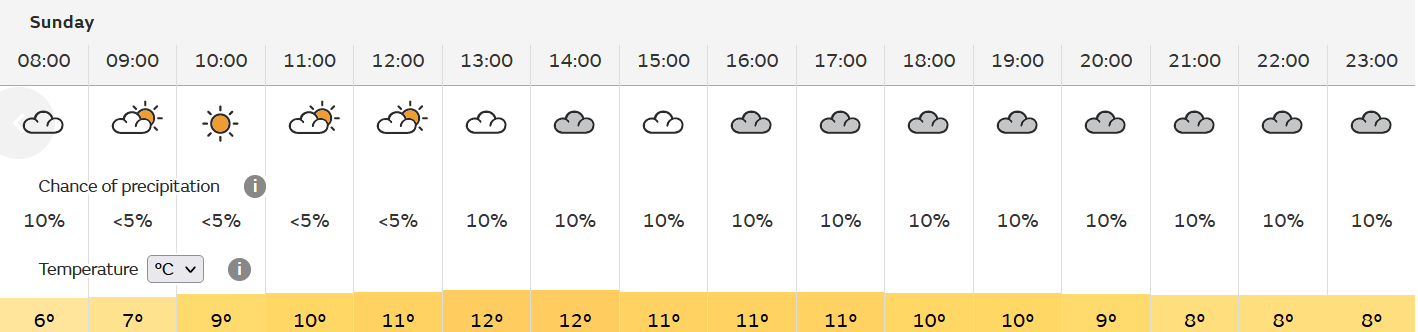

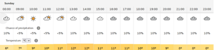

There are problems doing that, but three items have the delayed start option, the washing machine, tumble drier and dish washer. So even without solar one can gain from the split tariff. My tumble drier is the heat pump type, this is a small problem as one has to consider what the weather will be like 2.5 hours after it has started. And the washing machine we use to fill a ball with the soap, however with the delayed start it still turns the drum a few times to work out the load, so the soap now much go in the dispenser.
This
is not much help deciding what the day will be like. Even the Met Office 1711842254851.png the little pictures are useless to work out likely sunlight, it gives all sorts, temperature, rain fall, humidity, this 1711842491511.png may help, shows 11 am to 2 pm UV is 3 to 4, does this relate to sun light?

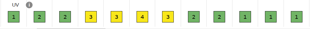

This is an index, developed by the World Health Organisation, called the 'Solar UV Index'. It shows the strength of the sun's ultraviolet (UV) radiation. The index is split into categories (Low, Moderate, High, Very High and Extreme). We have included advice about what you need to do to stay safe in the sun for each category.
and is 1 to 11, but it has warnings like "Take care during midday hours and do not spend too much time in the sun unprotected. Sunscreen advised." but as to how this relates to solar production not sure?

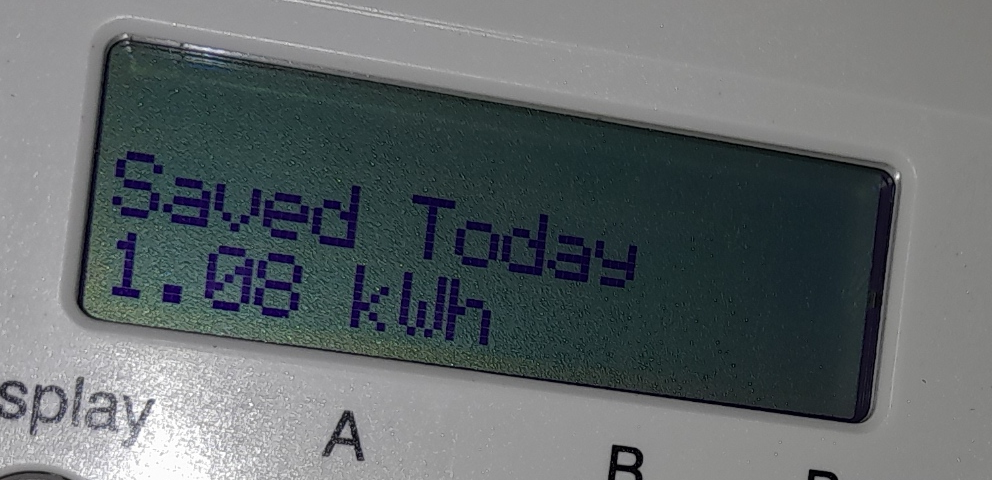

A single shower needs about 1 to 1.25 kwh of lecky to bring the hot water back up to fully hot - assuming the tank was completely hot during the boiler hot water heating during the night. When the daughter was at University, and during the summer months, we could rely on the solar divertor to provide all our hot water.
