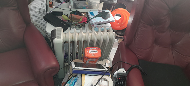

So we have this 1792157717638.png the oil filled radiator which is reasonably safe, and so can be placed as seen here, right next to the chairs, so heating the area of the room where the heat is required.
But will it waste or safe money? And that's the big question?

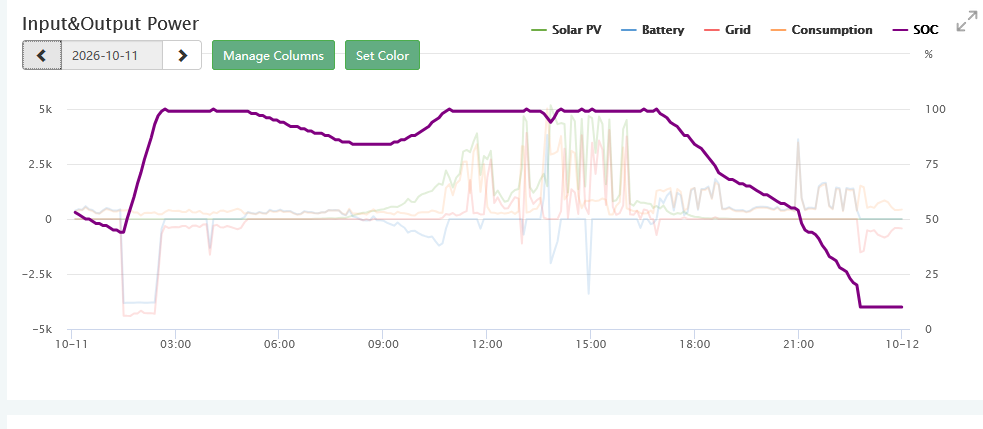

So last cold day 1792157966835.pngI ran out of battery, so electric costing £0.3074 per kWh around 3 times the cost of oil.
It would also have used some solar at 12p/kWh but more to the point, delivering heat direct to the point where it was required, so likely using far less energy to using the central heating, which has not been used at all this season.

I am using a smart socket adaptor for the oil filled radiator, so set to 90 minuets (using same setting as for the AC in summer, so did not forget to empty the condensate bottle) so when cold I turn it on for 90 minuets only so 1.5 kWh.
If 1 kW is not enough the radiator does have three outputs, but at the moment my thoughts are if 1 kW is not enough likely I need other rooms heating so time to turn central heating on.

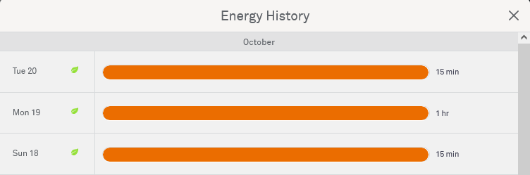

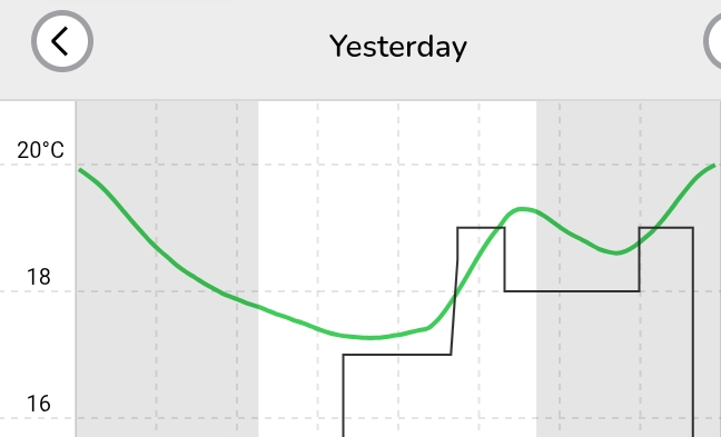

So I look at the reports 1792609167480.png and it seems Nest has turned the heating on, as under 17.5°C at some point. Wiser, 1792609535763.png it seems likely it also turned on the heating. The result is, I really have no idea which system has turned on, just the desk thermometer is showing 21.5ºC so something has heated up my home.
