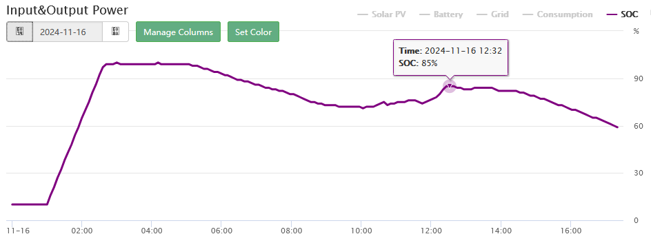

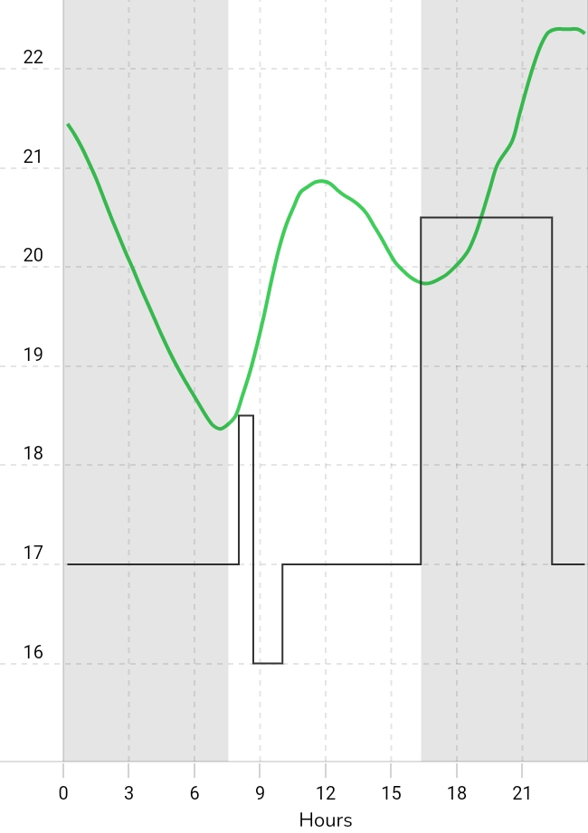

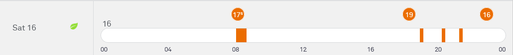

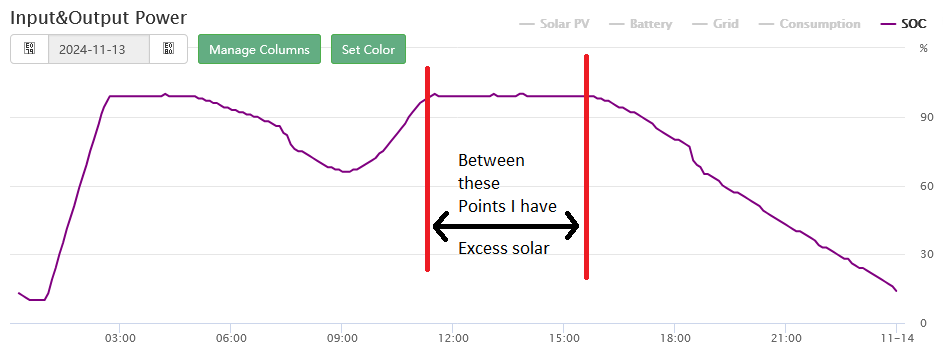

Yes, I have 6.4 kW of battery. But 1731777758123.pngI have marked where I have excess, but it varies day to day, and today no spare solar 1731777920906.pngonly charged to 85% and likely by the end of the day, will be using peak rate power. On the good day, down to 14% so as soon as state of change drops below 95% want to remove any load. But the good day shown, exported 6.1 kWh and the wall thermostat shows me 1731778478066.png so it seems boiler activated for a reasonably long time, which is common when we get clear skies, it does not mean the boiler was outputting full 20 kW at those time, or even if the boiler was running outside those times, the other thermostat shows 1731778877238.png so between 4 pm and 7 pm the other thermostat was activating the boiler, so boiler could run 4 pm to 9 pm, it may have cycled on/off, but 6.1 kWh of electric heating clearly would have reduced my oil use.
So looking for if SOC exceeds 95% then turn on heater until SOC is less than 90%, but I have no real option to run IFTTT with an oil filled radiator.
But I am sure I am not alone, so asking if anyone has worked out how to use energy rather than export it?

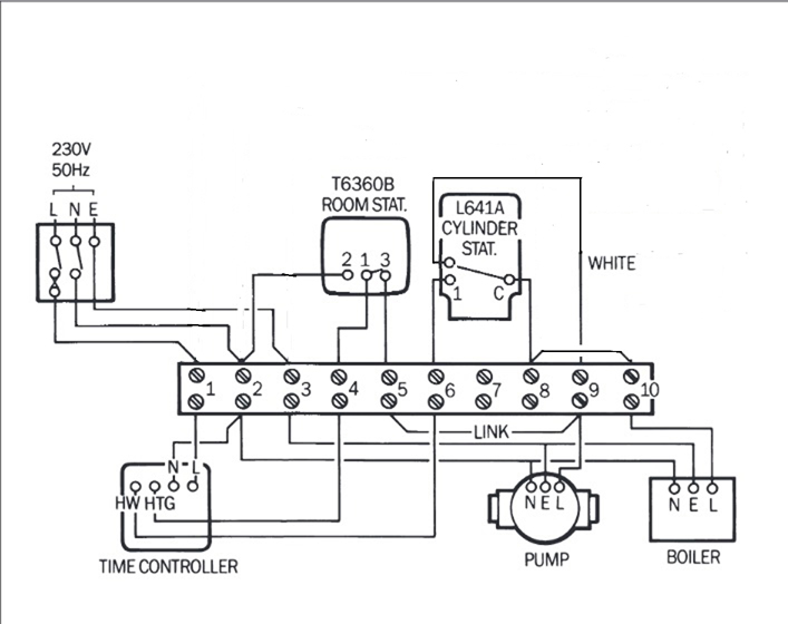

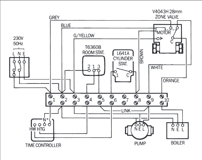

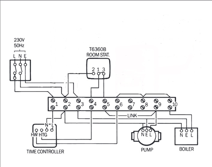

There are 3 C Plans, 1731810446351.jpegC-Plan_old.jpgC-Plan.jpgthe first, only control of DHW is time, the second has a tank stat for the summer, and the third has a motorised valve. The idea with oil fired central heating is that the boiler can cool by heating the DHW, so not a good idea to fit the motorised valve, as then no where for heat to go when it switches off.

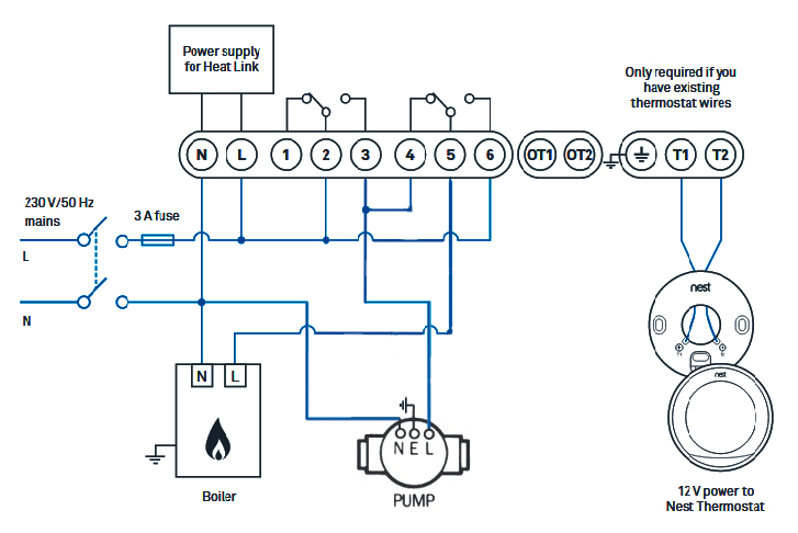

Using Nest Gen 3 C-Plan_basic_Nest.jpg slightly different as the output is common. Due to programmer and thermostat being combined, and Hive has a software fix, so one relay works the boiler and the other relay the pump. As far as I am aware, Wiser can't be used with C Plan, unless you know different?

I didn't know that. As so often, "one learns something every day"
.... the first, only control of DHW is time ...
but how is that achieved,if not with a motorised valve?
Controlling what? Again, I would have expected a motorised valve ... and don't all DHW cylinders have stats - or doe they just let the tempof the DHW rise up to that of the water coming from the boiler?
... and the third has a motorised valve.
OK
... but one can surely not rely on that,since if the water oin the DHW is already up to its 'maximumtemp, it will not be able to do any 'cooling, will it?

The original C Plan had not control over DHW in the winter, only in the summer was there any control, as said time only in the summer, before solar I would set it to 4 x ½ hour slots per week. The problem with this was it was a bit of guess work as to how long was required.
The first improvement would have been a thermostat, so it summer it only ran when required.
The second improvement was a motorised valve which gave control in winter as well.
