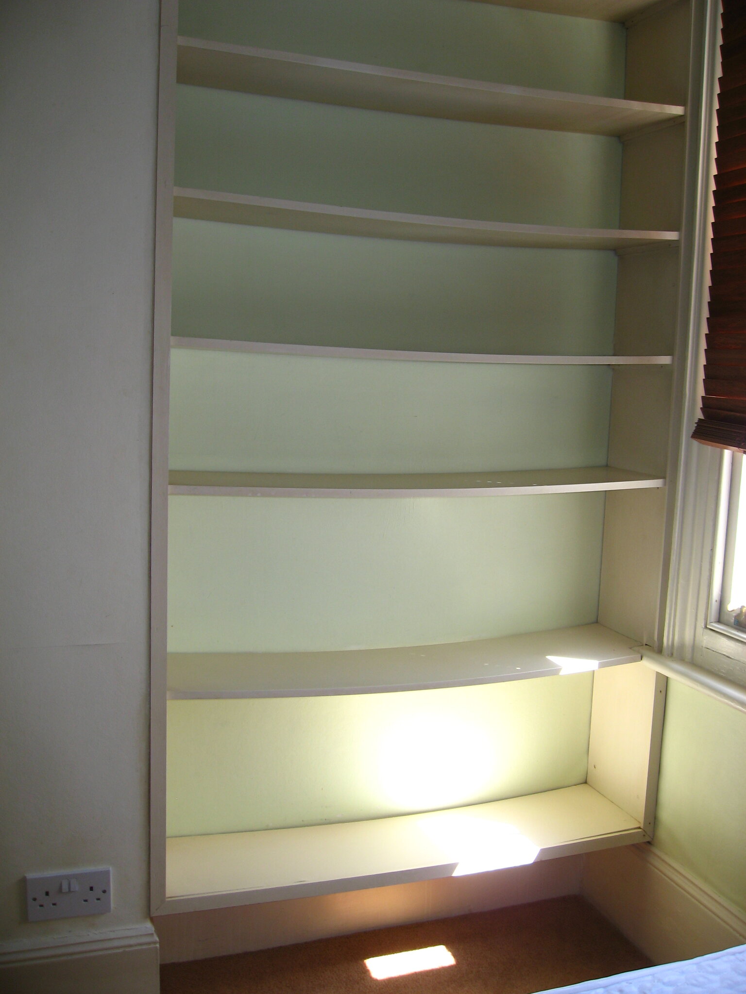

I've got a load of old sag going on, I blame it on all those diy programmes in the 90s.
They are 1.5 cm x 105 cm x 24 cm, attached only at the ends usually are half full of books, or lipstick and hairdryers if you know what I mean.
Can someone recommend the best reasonably prices material ?
White Oak is £35 a shelf of something.
Birch Ply is cheap but is it any good ?
thanks for your criticism and recommendations !

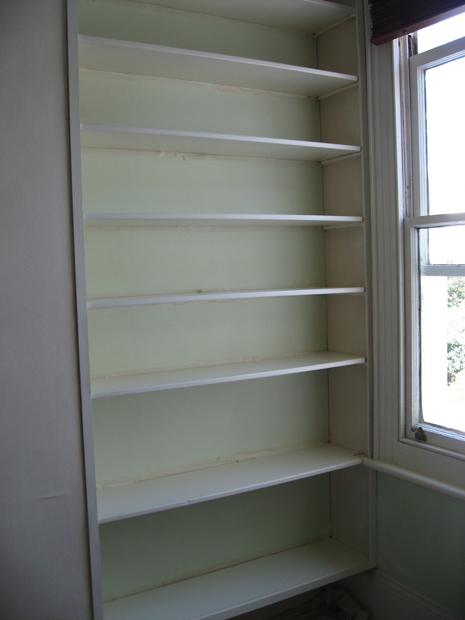

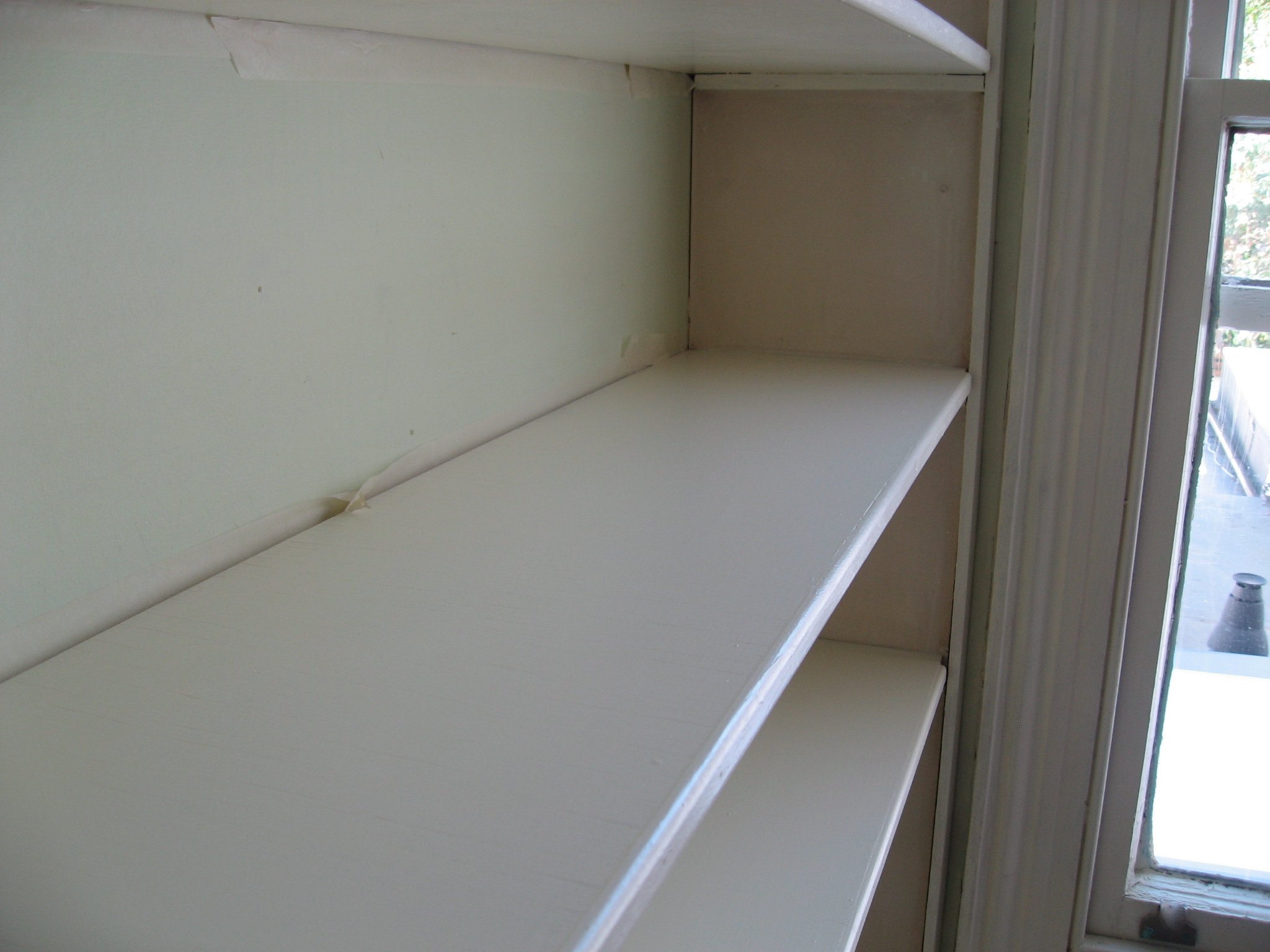

Rush job but finished.
B&Q 18mm smooth faced ply with cutting service
18mm D profile trim from Travis Perkins
Zinseer Bullseye+ 2 satinwood and no sanding
Bargain
