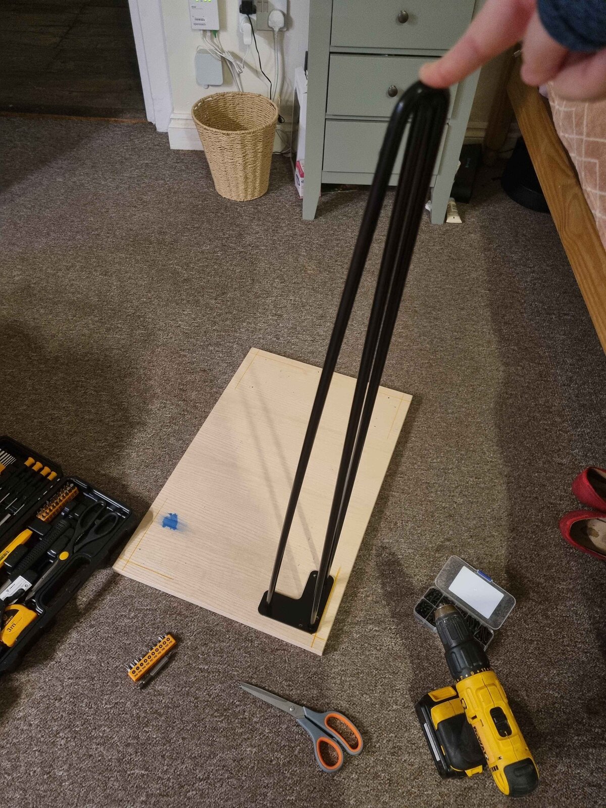

Have ordered 600mm x 400mm x 18mm MDF with moisture protection and 4x 90cm steel hairpin legs to make a temporary structure on which to keep the appliance.

MDF / table surface top is 18mm thick and legs are steel hairpin legs 90cm height
Screws provided with legs were 26mm length so am using 16mm length screws from own set with integrated washers
Legs are overkill for small surface size of MDF but 90cm was needed as using next to kitchen counter

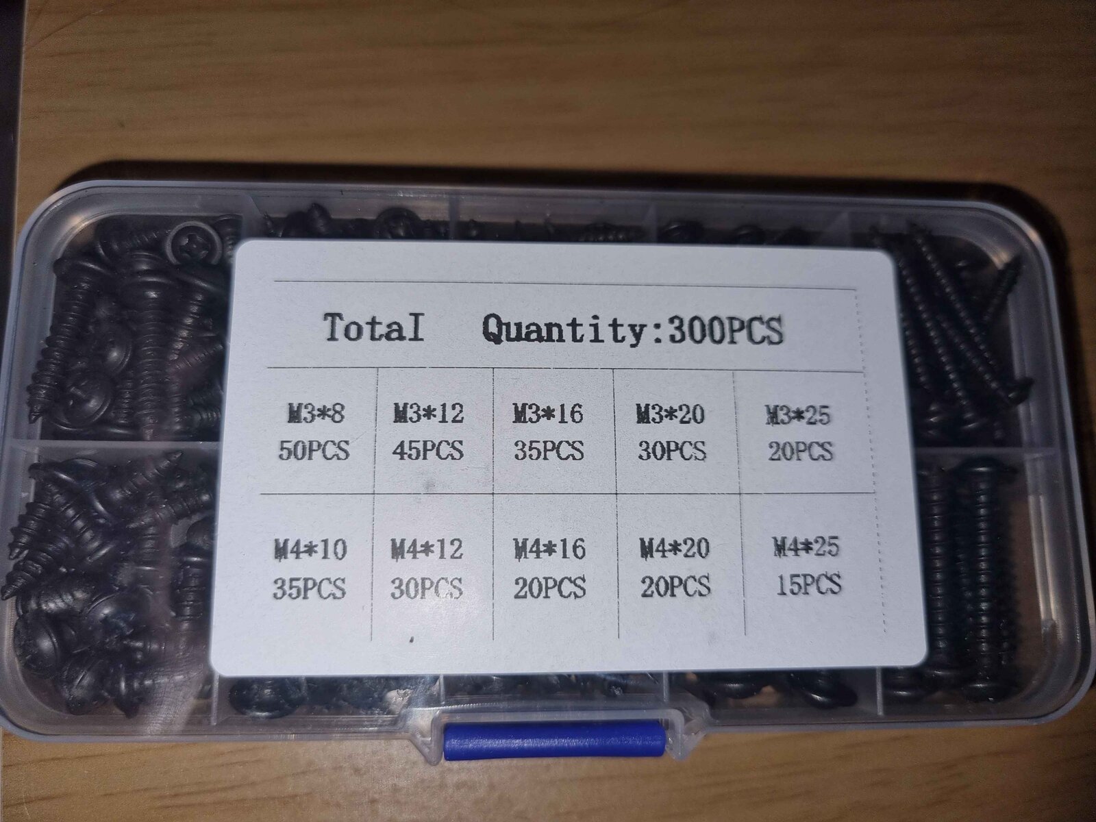

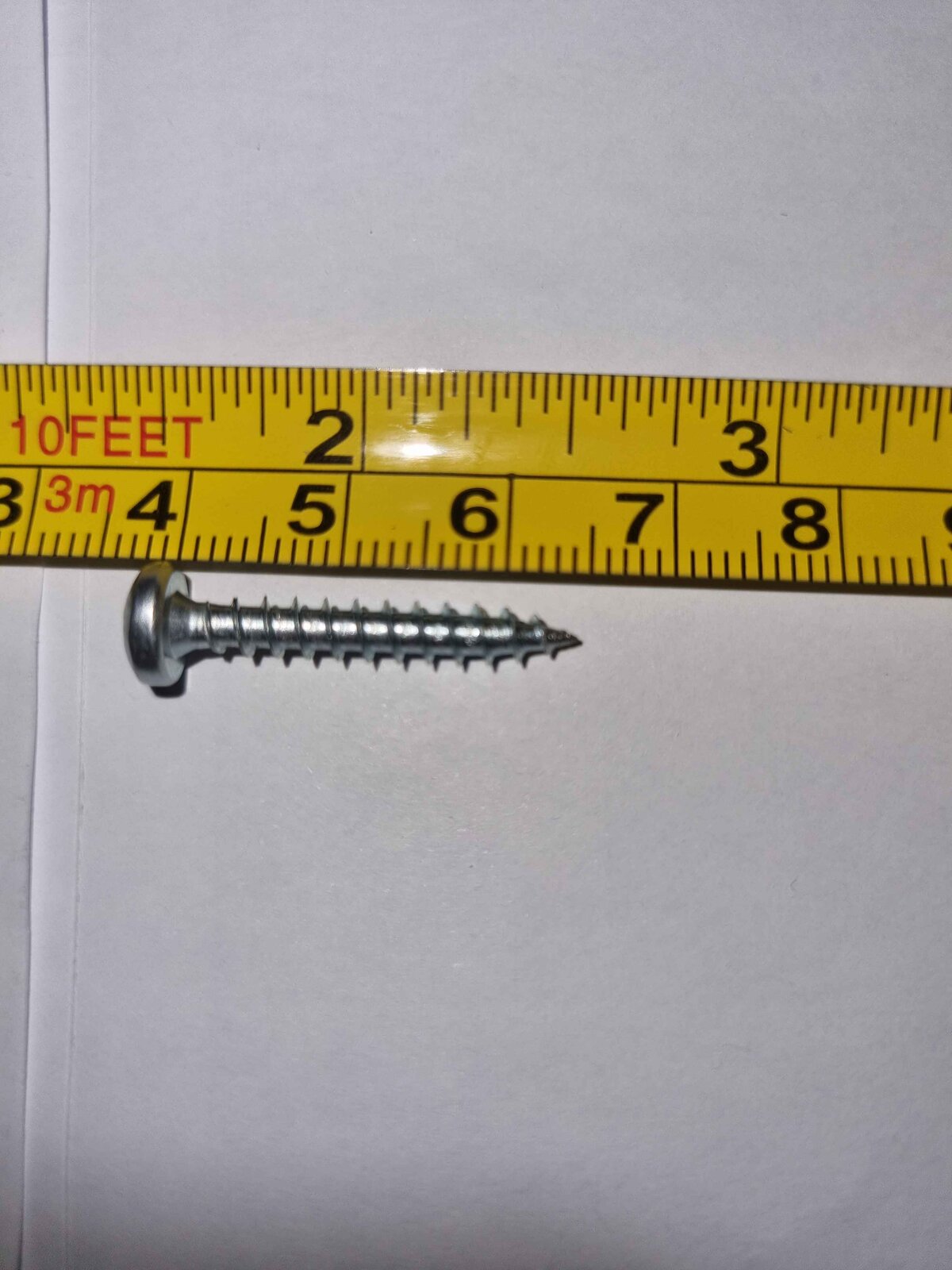

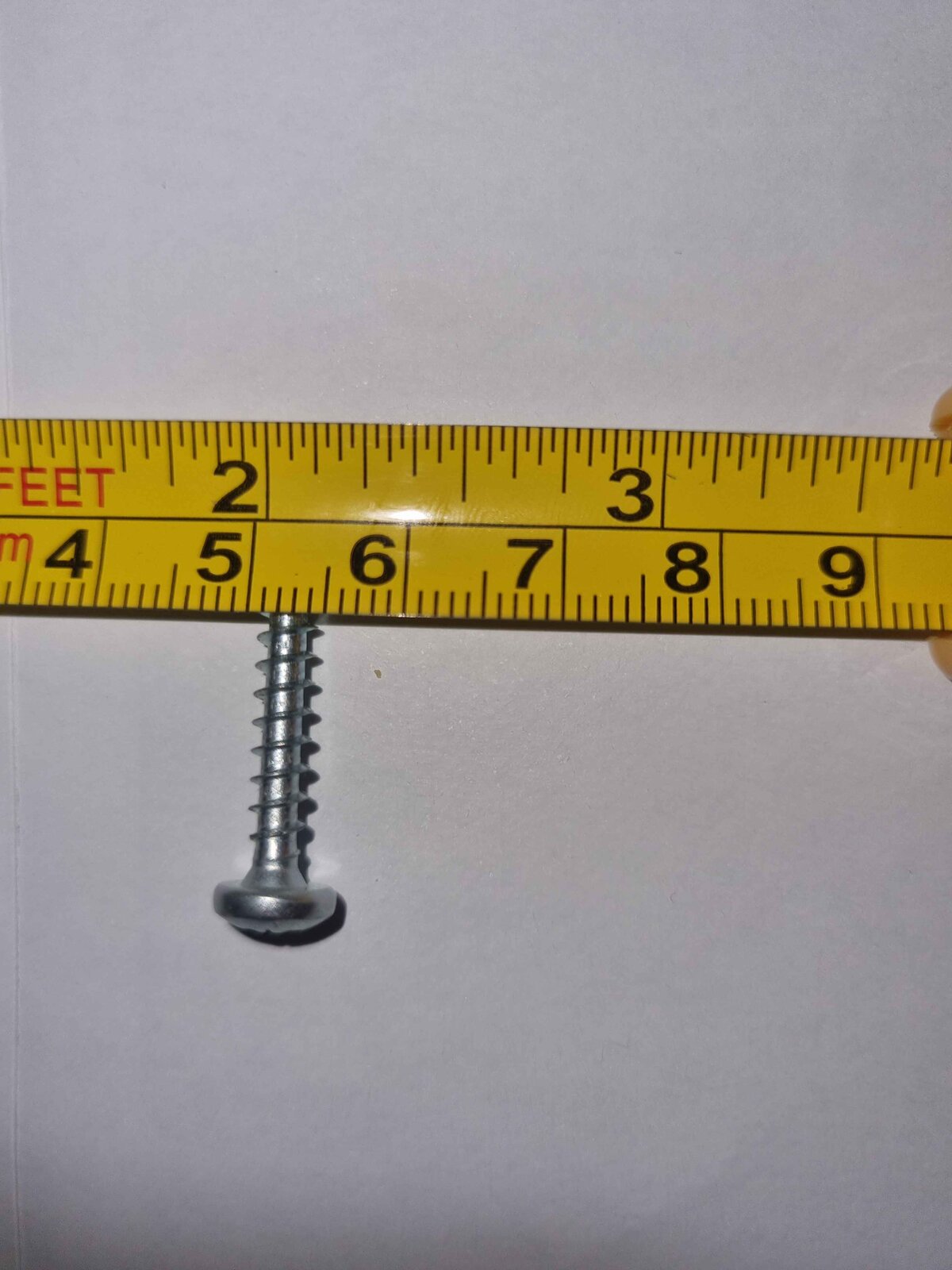

Looks as though screws provided were M4 & 25mm in length but as initial question was re drill bits I was using a 3mm drill bit for pilot hole as per YouTube advice because the solid internal screw shaft sans threads was 3mm
MDF is 19mm thick so the 25mm long screws provided would have breached the top surface of unit when screwed up from bottom

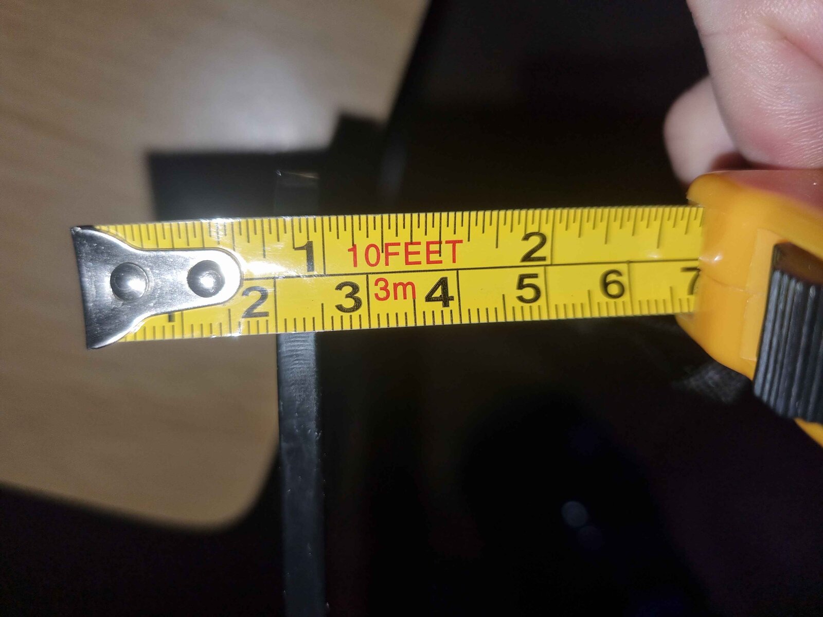

Leg bracket is apparently 4mm thick (photo 3) & available screw set is shown below (photo 4). Theoretically an M4 20mm long screw should work if 19mm MDF plus 4mm bracket thickness = 23mm. Screw head diameter in my other screw set was too small & cleared through the holes in the bracket so had ordered the set with integrated washers for larger head diameter. I didn't know which serch terms to use for 'bigger headed' screws so screws with integrated washers was closest that I could find in next day delivery options on Amazon.

Hairpin legs are from Etsy:

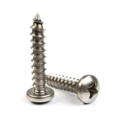

XxinXrong300 Pcs M3 M4 Cross Head Self Tapping Screws with Washers, Pan Head Self Drilling Wood Screws Assortment Kit, Round Countersunk Head Machine Screws Fasteners
I am open to ordering different screws as would rather do the job properly but am otherwise in over head with all the different screw types so yeah open to advice on which ones to get & from where
Possible screw alternatives could be M4 x 20mm Phillips Pan Head Wood Screwsor some 4x20 A2 screws but again cannot see head diameter for those

a couple of washers or grind the point off
stopping short to stop them showing on top is a gamble that will probably be fine
