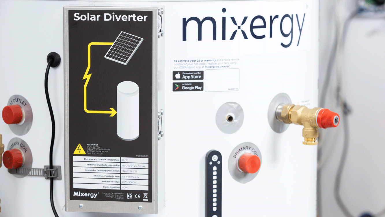

I guess I am trying to reinvent the wheel here but hear me out. Seems in the year 2022 we still have to second guess how much "hot" water is remaining in a hot water tank. Our family usage varies dramatically from day to day, some days we might as well stick the tank to permanently on (governed by the tank thermostat) on other days we're better of controlling via a timer as it's only required for 30 mins of the day. There are occasions when 3 people will shower one after the other with nothing left for the 4th person and there are occasions when only one person is at home for 2 days. There is no way of telling what our day to day usage is going to be in advance. Always on = wastage if no one is using for 2 days. Timer = Assumes constant routines that don't change much day on day. Neither really cut it IMO.
Clearly, in this modern day and age, it would be beneficial to have a method of determining when the available hot water is getting "low" (I get there is no such thing as low in terms of quantity but I'm talking in terms of temperature). And then use that knowledge (should we wish) to heat the tank some more. We can in theory do that by being able to determine what the average temperature is inside the tank.
I have not come across any tank design where the manufacturer chooses to reveal the internal temperature. The probe sits behind the thermostat, the capability is there in theory to determine this temperature but there's not a single temperature gauge to be seen.
As manufactures of tanks have no interest in fitting smart temperature sensors that can be interrogated by Wi-Fi, RF, BT or Zigbee ($10 tech), my question is where is the best place to self install a sensor to determine the "internal" tank temperature? That sensor could of course sit near a pipe (that is somehow linked to the internal temprature of the tank). Of course even if I find that spot, it would be a learning/calibration exercise to determine which temperature value means I'm "getting low on hot water" but that's a separate problem.
Thoughts, suggestions, alternatives? Thank you
I've wondered about this myself. In the old days, before cylinders had bonded insulation, you could feel the copper itself, and see how much of the tank was still hot. That experience flags up a problem with measuring the temperature. The cylinder doesn't cool evenly. The new cold water comes in at the bottom, and the remaining hot water stays in a layer on top. It's called stratification. So often it's a case of how much hot water is left, rather than what is its temperature.
I think Mixergy make a cylinder with a sensor which shows how hot the water is at different levels in the cylinder.
I can help you a little with that...
If you buy a few of these - https://www.ebay.co.uk/itm/225084166392
They run on battery, so no actual wiring involved.
You can make a tiny hole slopping at an angle into the tank insulation, into which you can push the probe tips, at regular places along the height of the cylinder. Mount the displays in a panel, and they will provide a very good idea of exactly how much hot water you have remaining in the cylinder. I would suggest four of the displays might give you the resolution you need, but be aware the water in a cylinder, only gets hot above the heating coil, or the lower end of an immersion heater.

However, there are some interesting features, such as apparently modulation:
But what fascinates me more, is the 'Smart' nature of the device and the companies work with the national grid to develop a "1MW frequency response service" and "DESIRE - a Distributed Energy Storage Integrating Renewable Energy" - a system utilising smart tanks for load distribution.
