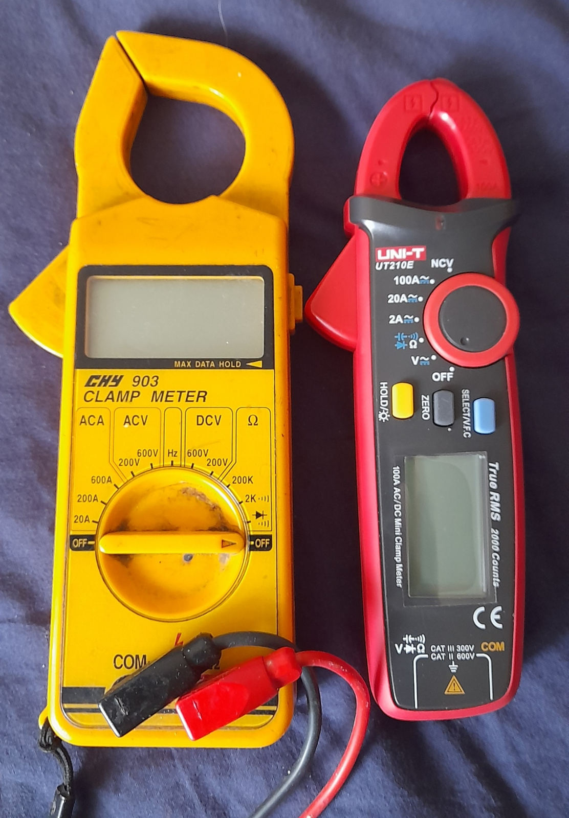

Hi, I wanted to check my electric meter for accuracy and was told a clamp meter would be best. Can anyone tell me how to do this or is there a better way?
The old and new 1663845569534.png both are clamp on meters, left one was cheap bought it in Hong Kong before take over, so shows it's age, and it will show 0.01 amp, one to right less than a week old will show 0.001 amp and also works with DC.
Clearly would not have got second if first could do it all. But they show current in real time, so one can assume power factor of unity and 230 volt to work out watts, but it will not show the same as the electric meter, as they are measuring different things, the clamp on measures power the electric meter measures energy.
So a watt is a joule per second, and the joule is a very small unit, so since 3600 seconds in an hour, the are 3600 joules in a watt.hour. So we use kW.h with the electric meter but kW with the clamp on (after some maths) so they don't measure the same thing. May seem odd but there is no time in a kW/h (the two times cancel each other) but there is time in a kW.

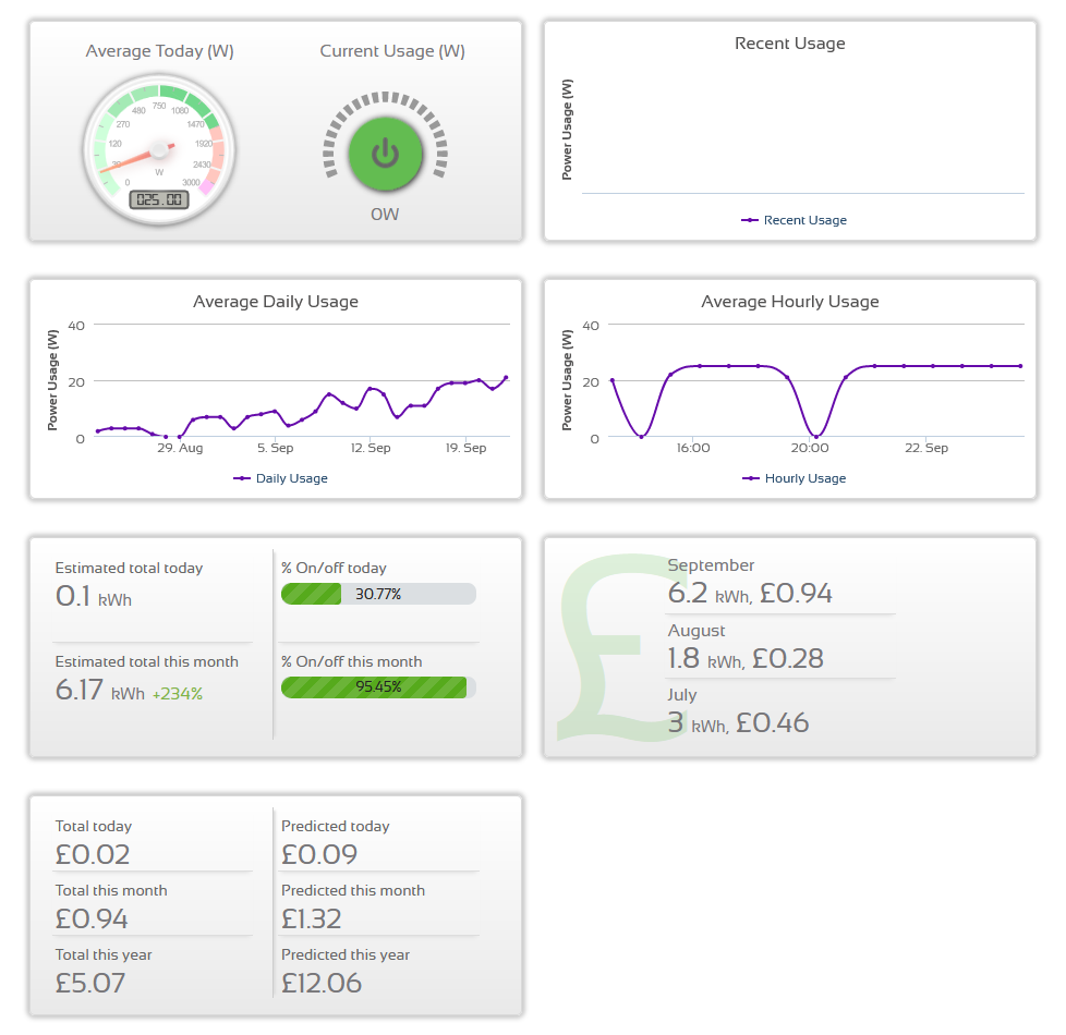

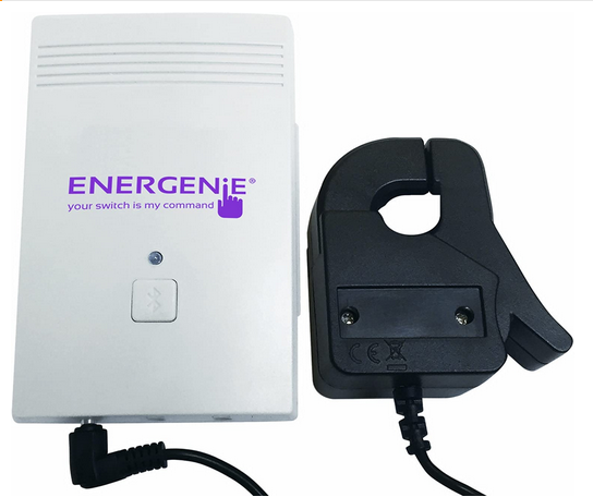

A device like this 1663846328175.pngwill measure nearly kW/h I say nearly as it has no power factor correction and assumes 230 volt. I have the plug in 13 amp version and would assume similar so you will get some thing like this 1663847034937.pngI am using it to see if beer is warm enough, but in many ways the plug in monitors are better, what seems odd is in many ways the non computer connected device tells you more.
However to show you that picture I had to re-boot the device, don't know when it stopped, but clearly you could not use that to show errors with an electric meter, it would need to be a calibrated data logger.

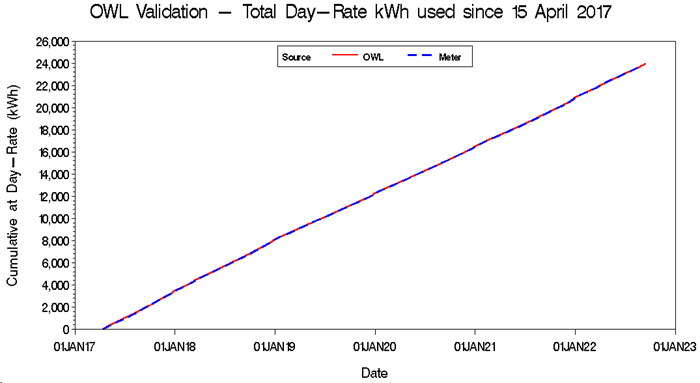

The Shelly EM recommended by taylortwocities above is adequate to test the accuracy of the meter. It uses a current clamp on the live feed between the meter and the CU. Take a meter reading, connect the current clamp of the Shelly EM. Carry on using electricity as normal for a period of time (perhaps a day or a week). Read the meter again. If the kWh recorded by the Shelly EM (visible in the Shelly app) is the same as the difference between the two meter readings then the meter is ok. The Shelly EM is pretty accurate as it is connected to the mains supply to read voltage and current simultaneously.
Indeed - I would say 'more than adequate'. Any sort of clamp-based device, even if without any wired connection (hence requiring guessing/estimation of voltage and PF) is likely to be adequate for identifying any significant inaccuracies of the supplier's meter, particularly if used over a reasonable period of time (ideally at least a few days).
In my, albeit limited, experience, in the great majority of cases in which a consumer suspects the supplier's meter, there's actually nothing wrong with the meter, the problem being their underestimation of their electricity usage! However, on the few occasions in which the meter is apparently inaccurate, the inaccuracy is (again, in my limited experience) usually fairly 'gross', and easily detected by any clamp-based device, as above.
It may be time to again wheel out my illustration of how measurements from my OWL monitor (clamp, but no direct mains connection) have compared with figures based on my supplier's meter over the past 5+ years. The system uses 'constant' (reviewed annually, but rarely changed appreciably) estimates of average voltage and PF and, as can be seen the difference between my and my supplier's figures are as close to zero as makes no difference - in fact, currently a cumulative difference of only about 20 kWh in about 24,000 total kWh since April 2017 (about a 0.08% difference) ...
