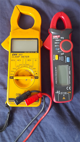

I had same from Scottish Power, but the simple clamp on meter, Clamp-meter-small.jpg will show usage, but not over what time, this one £17 likely there are cheaper ones did not really hunt. And at the meter clipped to tails you will soon see what each circuit uses, if you want one to measure DC the price starts at around £35.
To be frank most devices have wattage marked on them, where it varies hard to work out what has gone on with all items together, my old Sky box seemed to use far more than expected, seems it needed the power the LNB, one item here showing a battery charger Linda car charging2.jpgI can see what it uses and when, but grouped together it shows very little.
I had same from Scottish Power, but the simple clamp on meter, View attachment 280654 will show usage, but not over what time, this one £17 likely there are cheaper ones did not really hunt. And at the meter clipped to tails you will soon see what each circuit uses, if you want one to measure DC the price starts at around £35.
To be frank most devices have wattage marked on them, where it varies hard to work out what has gone on with all items together, my old Sky box seemed to use far more than expected, seems it needed the power the LNB, one item here showing a battery charger View attachment 280655I can see what it uses and when, but grouped together it shows very little.
Yes, I was thinking of one of these. But, like you say, most items we own have a stated, or easily estimated, energy usage so some kind of logging would be useful.
Our usage is 4x typical for a representative household so I'm guessing there is a single culprit using more than I'd imagine. In terms of being able to discern it amongst all the other usage, I'm betting on a single constant load making up the lion's share of our base load or a very high consumer used intermittently. Hopefully this will make it easy to spot them.

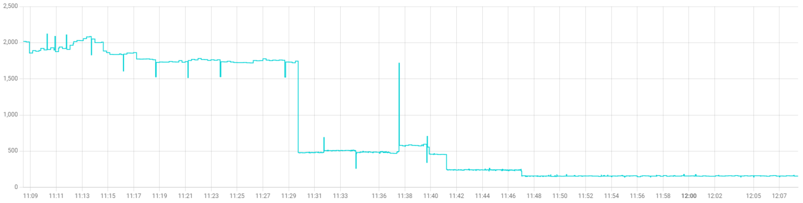

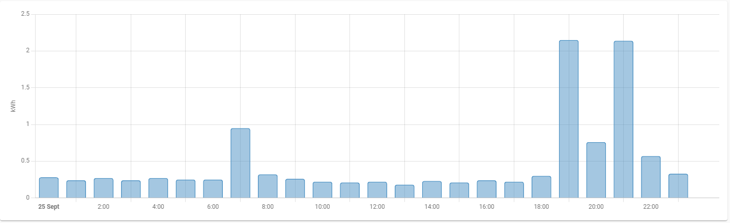

The Shelly app keeps 365 days of data. I use the Shelly EM in conjunction with Home assistant which can log power usage at 15 second intervals for 10 days or at hourly intervals indefinitely. That gives me lots of control over what I can see.
Yesterday:
Now:
The last hour:
