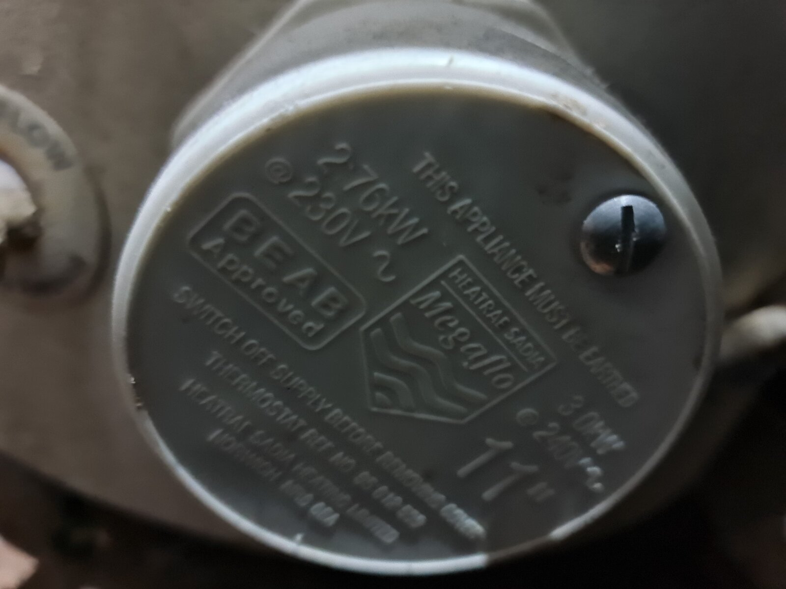

My customer had the man from British Gas out to do some work. It looks like he accidentally knocked off and lost the cover from my customer's upper megaflow heating element.
Here is a photo of the lower element cover
I can find a similar cover but it seems to be secured with a nut. I am not sure that the bolt on the fitting will be long enough to accommodate a nut rather than the screw head thingy.
The guy left it with no cover after he worked on the boiler next to it... There was power running to both of the elements. I have since turned off the power to both the upper and lower- one is a switched fused spur, the other is just a switch? No idea why they were both live in the first place.
Any replacement recommendations? Thanks

I noticed it missing on the Tuesday. BG had been there on the Saturday before. I had last previously been in the utility room two days before BG. I am pretty certain that if it had been missing before his visit, I would have noticed.
When I noticed it missing I covered it with a plastic milk bottle and asked why it was live in the first place. Rather than being annoyed with BG the customer seemed to be more happy to discover that his electricity bill would drop if he turned both elements off. Bizarre.
I think it wants a Sleeve Nut. Around M4? Perhaps M6
May be same size used on door handles
