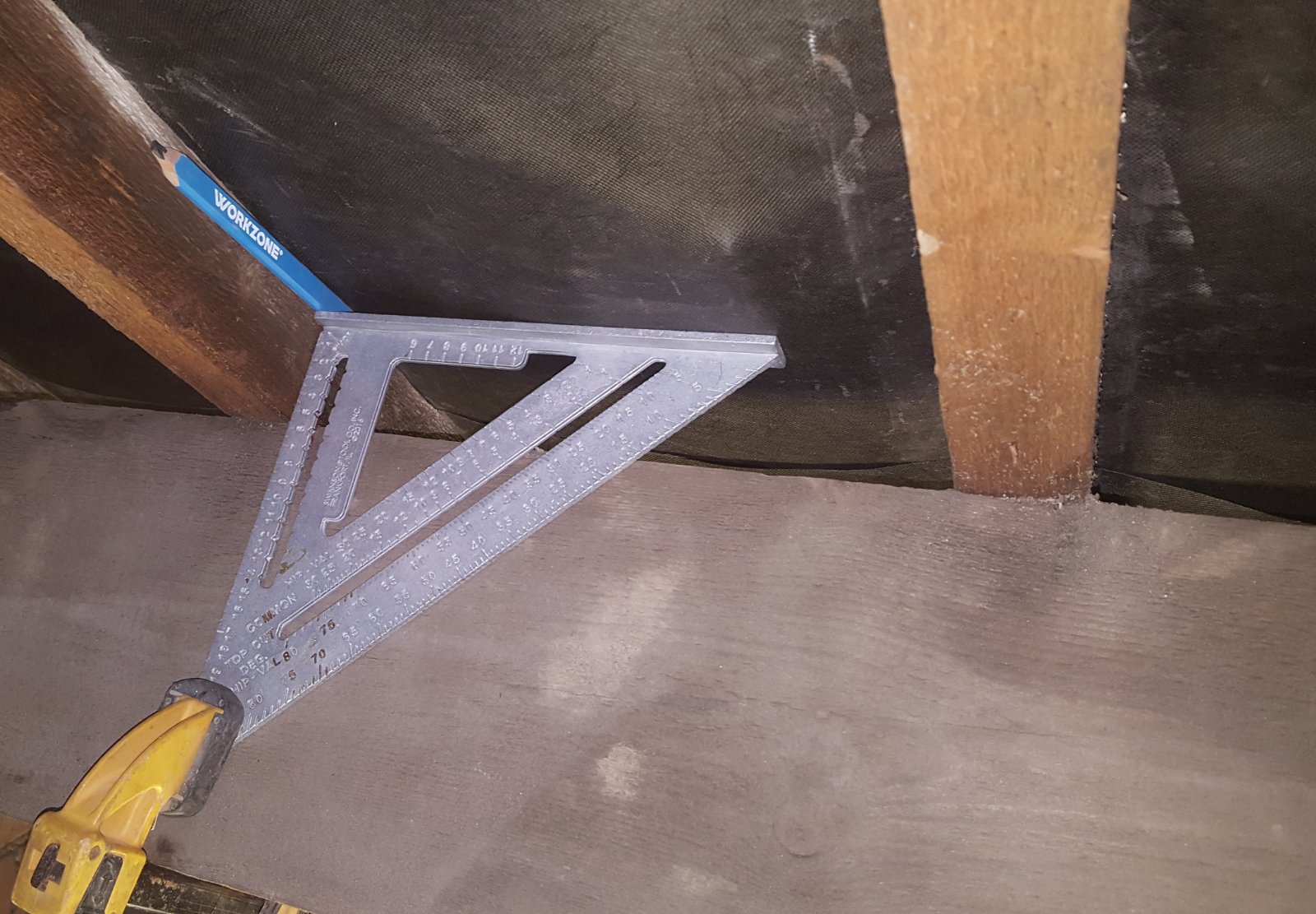

Hello,
After a recent re-roof I notice something trying to bust through the membrane into the loft space.
I have worked out that it some mortar from the chimneys brickwork relaying.
I think after not to long with weather changes and general roof movement the mortar junk is going pierce through leaving a hole.
What can be done before or after that happens ?
Thanks.

In the past when a cracked slate was replaced, it was secured with a lead tag or some adhesive.
So with a brand new re-roof I did not want to see a lead tag.
Adhesive, how long does that hold.
Not a worry I needed.
If that is a lap in the membrane, then you may be able to get a hand in and get it out.
No, there is no lap there between those rafters. I think that is the purlin shadow.
Had another look at my pics. The lap is there, it is about 6" below the protruding object.
I would have to crawl below the purlin into eaves area, shove my hand/arm down into the lap and then maybe try bounce the object to fall into my hand. Which I don't think is like considering how much it is already trying to burst through the membrane into the loft space.
I will go up though tonight/tomorrow and have a look to see if it is feasable.
