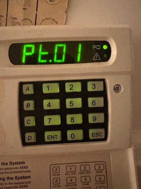

Evening all, i'm not sure whats has gone wrong but I tried to change the time E2 Menu than afterwards the alarm pad not excepting my 4 digit code. I didn't change it. This is the error that is showing PT.01 CodeTamper (fromremotekeypad**) The Engineer Code works. Can somebody tell me how to fix it. I know it's an old system but it was working fine prior.

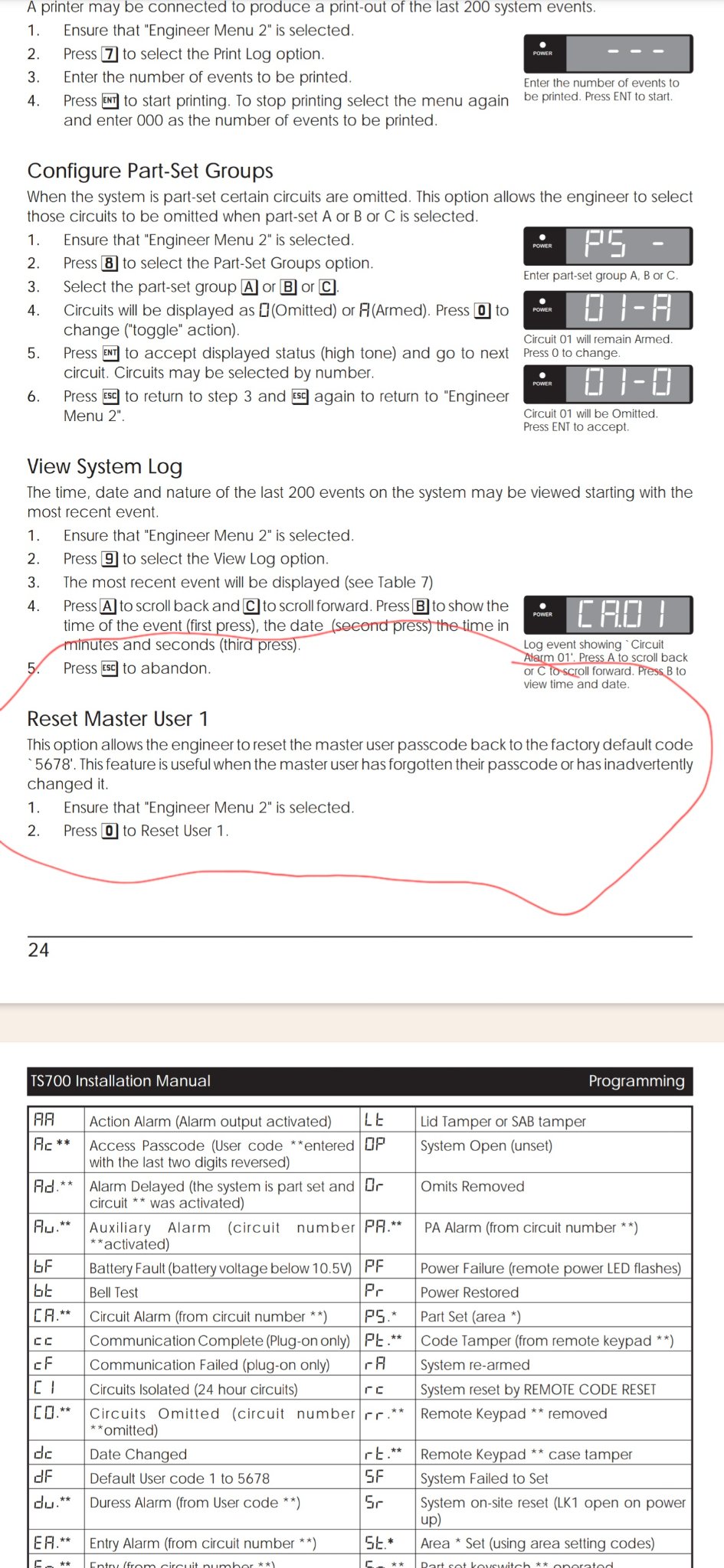

Try this if you have the engineer code.
Hi Rulland I saw that option but all I did to my knowlege was try to change the time. If this works will it erase all the programming or just default the user code to 5678 or 1234?
Morning, as per the screenshot, just resets the master user code back to the factory default of 5678, all other programming is untouched.

Morning Rulland, doing the steps has worked. But I had to change the Engineer code because both menu would never have worked with the same code. I have a slight issue the default code and my own code are both present how do I remove the default one? So I thank you for your guidance.
