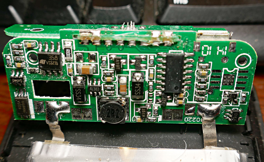

I am working on a product for my GCSE Product design controlled assessment, and I was wondering if it is possible to create a circuit with a rechargeable battery which can take input through a micro-USB socket. Does anyone know if this is possible and how I could do it, if so it would be a massive help. Thanks!

Do a search for "5v battery charger circuit" and you see lots of circuits.
https://www.google.com/search?q=5v+battery+charger+cuicuit&ie=utf-8&oe=utf-8&client=firefox-b-ab
Note that it is critical to know the type of battery (chemistry) you are planning on charging, as each type of battery has a different charge cycle.
Batterys explode if charged (or even handled) incorrectly.

Wot he ^ said. There's a large number of chips made to do exactly this, inside products.
Phones do exactly this, and just about all Power Banks do this.
Some are more clever than others, so find out exactly what they do.
What charge current do you want for your battery?
What current can you get out of a USB connector. Does it depend whether it's USB A,B, C, Mini, micro...?
You'll have to look up the specifications of them all.
Variations - many will cut back the charge current as the appropriate voltage is being reached then hold it at a very low level, and protect against short circuits, and against over-temperature, and give you a readout of the state of charge of the battery, and on and on.
Don't forget your materials - heat resistance, insulating, non flammable, etc etc.

Here's a couple I just happen to have on my desk. Both are broken so they're going into something else.
Sorry they're grotty pictures, it's a bit late. Let me know if you want them better. Both these are micro USB in, one has a phone-type battery, and the other a 18650.
