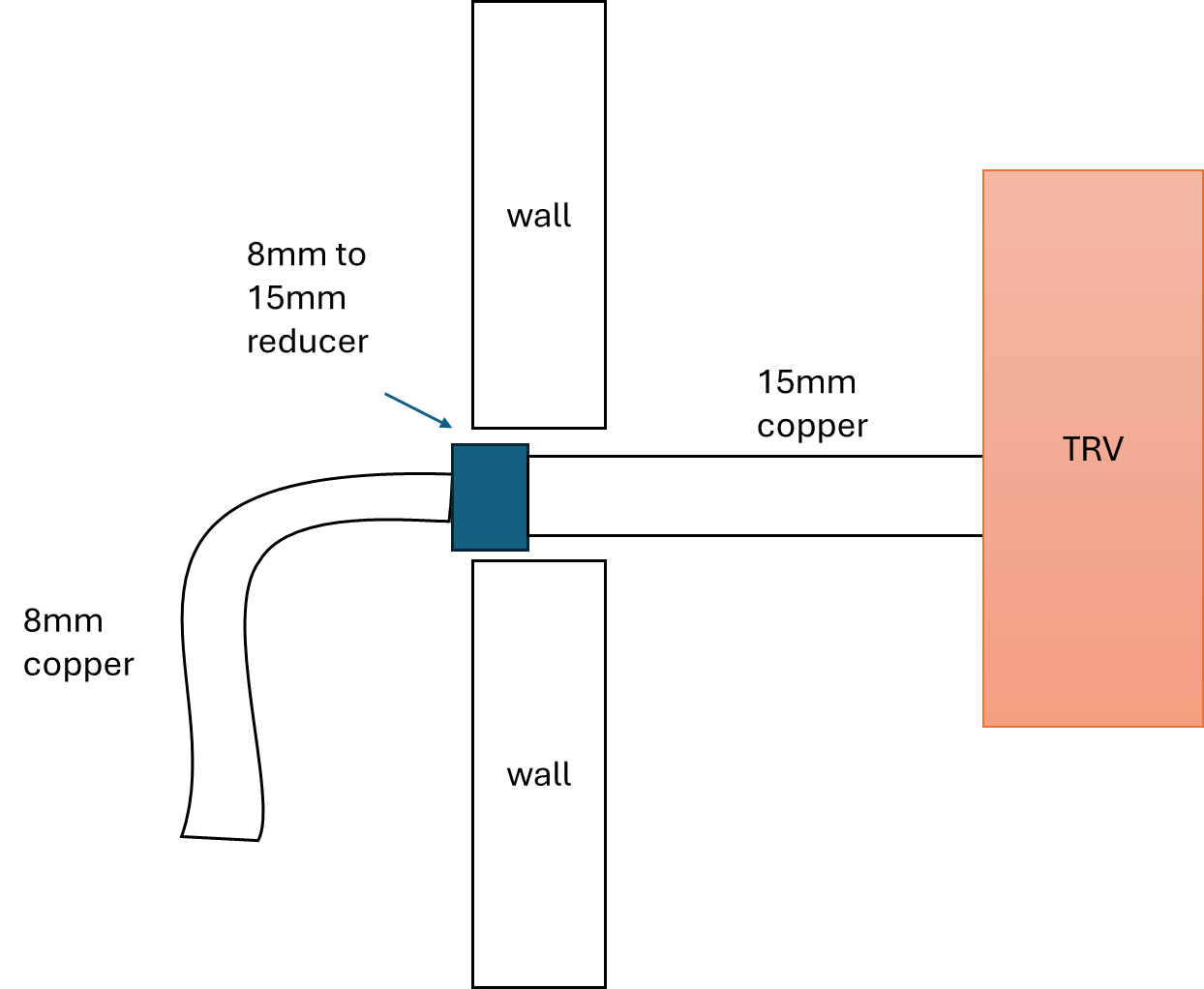

Hello Everyone,
I have started chasing heating pipes into my walls (to make it 'pretty' - wife insisted). I just moved in to this house and noticed that all rads are on 8mm microbores.
I am very not-used to 8mm pipes and one thing that I already noticed is that my TRVs take standard 15mm not 8mm. Also 8mm sticking from a wall looks s***t to me.
Would anyone be able to comment if the following idea has any obvious drawbacks? see sketch below:
Yes - the main drawback is > it's 8mm microbore. If you're doing all of this and chasing the pipework into the wall, then increase the pipe size while you're at it.
but then I will have to change all of them and probably up to a point where they come out from the original 22mm.
Too much floor cutting for me I'm afraid. maybe in a few years when I have more time and wife goes for holidays somewhere ;)
What is wrong with 8mm? lower flow rations? less heat to radiator?
Depends on the size of the system TBH - If you have a med > large system with say >8 med sized rads (=>600x1000 K2/Type22) over uneven distances then heat up times can be extended, balancing of the system can be troublesome and if the system isn't kept squeaky clean then it can suffer from poor circulation issues and blockages.
I'm dealing with a system right now that is actually 10mm and 4 out of the12 round top rads have stopped working - system was poorly managed and became dirty and the pipework has become blocked/restricted.
ok i've decided to change to 15mm all the way since i'm opening floors anyhow.
