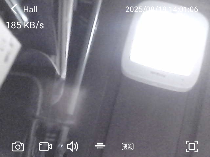

The black and white female was not, to start with, our cat, so the chip not put in her by the same vet, so maybe the chip is too far back in her body. The camera does not give a good picture, ⁣but 1755608576311.png good enough to see when there is a cat trying to get in. It was working fine with the two cats, it was only when the third was added, we got problems, most due to the third cat not being used to using a cat flap.
