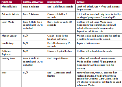

You've done a reset and erase tags. Then pair up again.
I guess you test by holding tag to trigger flap.

Looking at the how to on YouTube you don't need to hold the cat. You have 60 seconds to get the cat to eat a treat placed inside and that programs flap.
Looks easy enough although I've never tried.

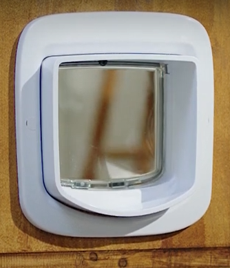

1745787376622.png There is quite a tube on the cat flap, I assume the detector is inside the tube, as it says do not cut it to length, when I fitted it, I set it up for cats first.
That was easy, but to program in place not easy.
