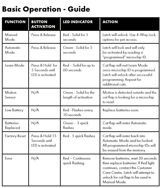

Most of the instructions relate on cutting a hole in the door, bit on how it works is reduced to 1716811661497.png which is very little is says "Remove the battery cover, set aside the provided hardware pack, and install 4 high quality alkaline AA batteries (LR6). The green LED light will flash three (3) times which indicates that the cat flap is in Automatic Mode." I have looked and there seems to be a whole range of batteries which say they are alkaline AA cells, often with trade names like Duracell which it seems are designed for rabbit hatches not cat ones, but no details of how much energy is in them.

The cell voltage depends a lot on what current is being drawn. If you measured 1.4V with a DMM and no other load, then whatever peak current the cat flap draws may well take the voltage down below what is deemed acceptable for that device.

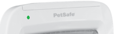

I am a little worried that our cats may not be able to get into the house, going out it does not need to read the chip in the cat, it only does that on return, I had heard them tapping on the flap, when it has picked up their chip it does show a green LED 1716848852871.pngbut where it is we only look when we hear them tapping at the flap, without grabbing a cat and sticking their head in the tube, it is hard to know if it is working. I read before fitting it failed safe, so discharged battery causes flap to unlatch, but now can't find where I read this so maybe it was another make of flap.
