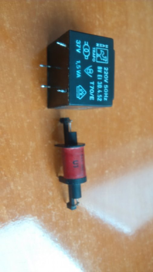

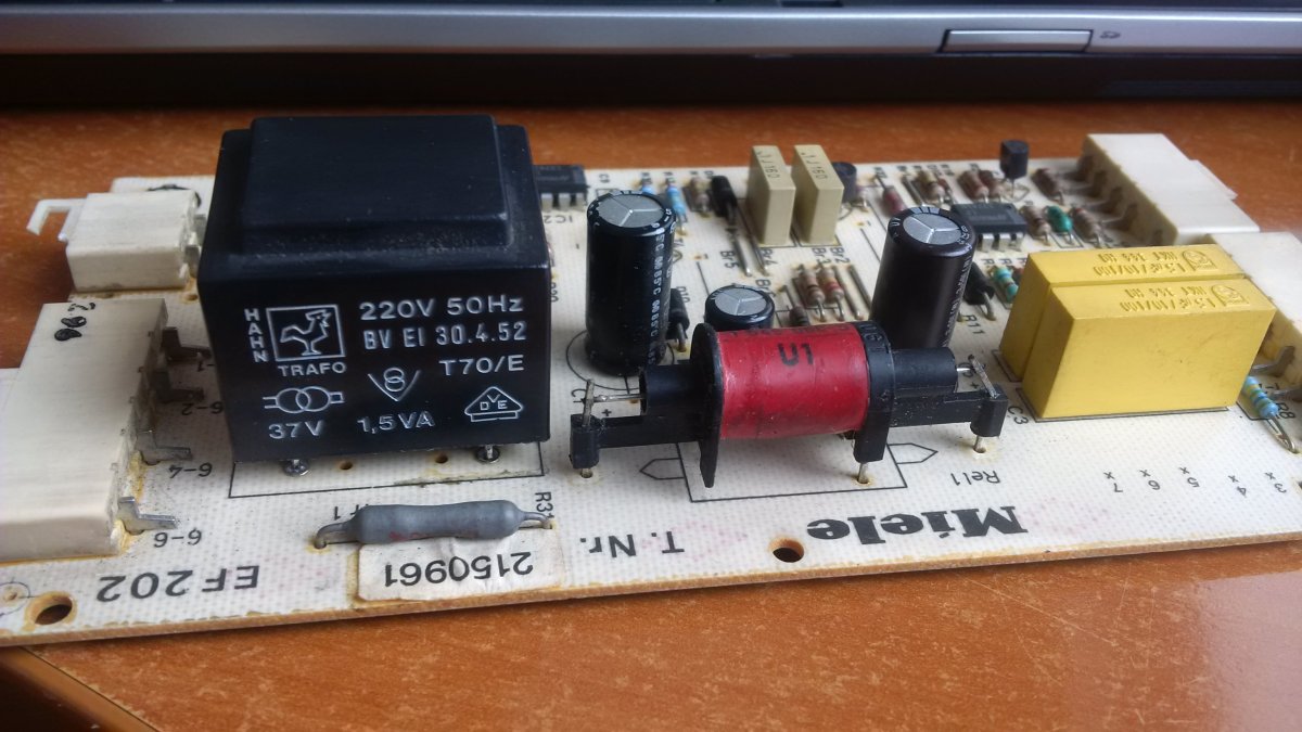

Good morning to all,
I have an old Miele T369C tumble dryer which is not finishing all the programs related to residual humidity sensing (extra-, ironing-drying, etc).
After many cups of coffee checking the internet in order to find out some information about the EF202 module, I decided to make some checkings, and I found out that the transformer and the reed relay are damaged.
I chased these elements through shops, internet, etc but I did not find them.
Do you guys know if there is a chance to still purchase them?? Or should I buy a new and complete EF202 module??
Thanks in advance and regards from the sunny Spain!!!
Andrés
Hello jj4091,
Yes, I did it at the spanish site, but no luck.
The problem is that the transformer has a seconday voltage of 37 VAC, which is out of any standard. Even at OEM site (Hahn) I did not find anything.
As for the reed relay, it has no marks on it that could help me identifying the OEM. There could be some alternatives on the market, but surely their coil current would be higher than the original one. Also, Vnom for this reed relay is around 32 VDC, which is out of standard.
Regards,
Andrés
