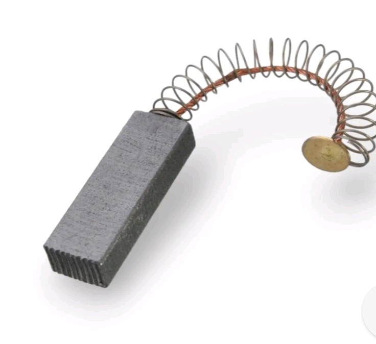

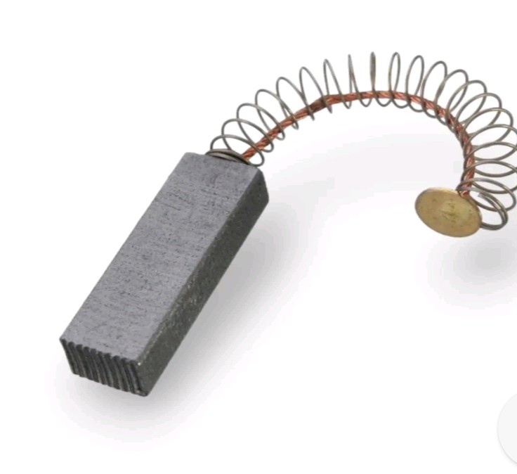

miele vacuum carbon brush holder

What has broken off, an electrician or plumber should be able to solder terminals or the brush retainer back on.
if you look at the pic... it's the brass leg sticking out of the bottom that has snapped off
Do you have the old one, if so it could be silver soldered back on, wouldnt trust tin/lead solder in that situation. If not have a google for a lucar blade terminal.
i might just buy a 'for parts only' miele from fleabay
you can pick them up for a bout £20 and I'll lift the carbon brushes out
I realise this is a very old thread but the same thing happened to my Miele C3 and carbon brushes with the brass holders are now impossible to get. The terminal that snapped off doesn't seem to have any "supporting role" so I just soldered a short length of wire between the broken ends with regular solder and so far so good. I'm hoping it'll be better than the original as it's flexible and so less prone to vibration stress.
Not sure if solder on in brush wires could melt when motor under a good load, Ive repaired with silver solder which has a much higher
melting point just in case
Thanks. That has occured to me but I didn't have any silver solder to hand and not sure if my basic 40W draper soldering station would cut it. What silver solder would you recommend? I have an infra red heat gun so could check max temp of my soldering iron. Also how do I change the carbon brushes keeping the original housin? I ordered brushes - see below. There's a fair bit left on the originals so I well leave well enough alone for now!

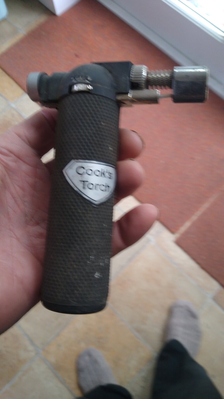

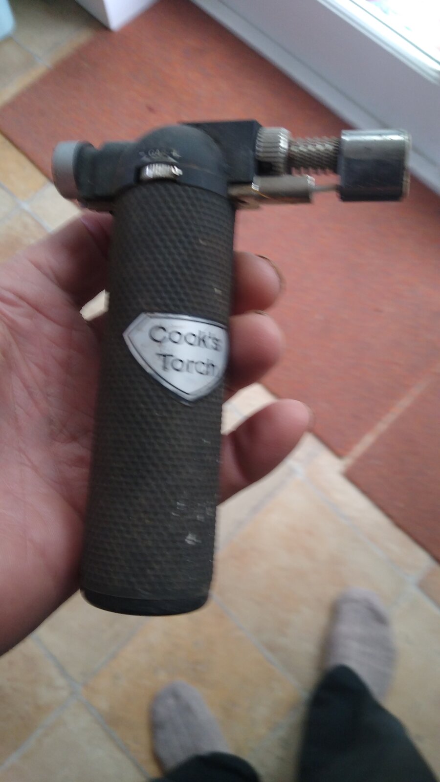

I have silver solder rods which I don't know the MP point of but needs a flame to run it. For delicate work I use a kitchen torch which does the job.

Also how do I change the carbon brushes keeping the original housin? I ordered brushes - see below. There's a fair bit left on the originals so I well leave well enough alone for now! View attachment 340304
Are there some tabs folded over on the top of the holders, if so fold them open, replace the brush and closed again holding the brush spring compressed .
A contact soldering iron doesn't normally transfer enough heat to silver solder.
