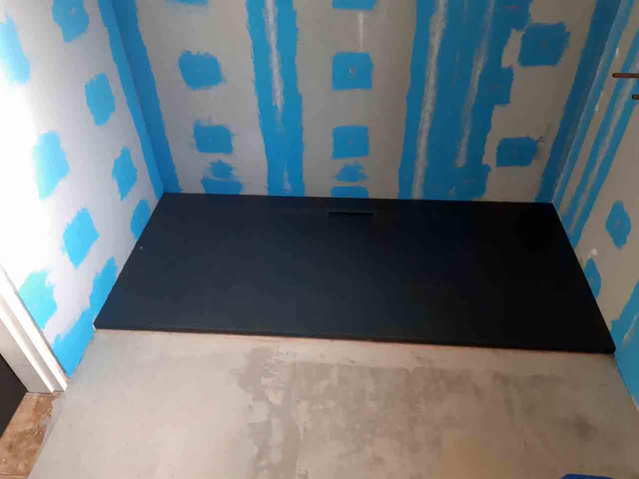

Can someone please explain to me why fitting the tray in the description above is not recommended using "dabs" of adhesive, rather than a solid bed of mortar when the tray can also be fitted on legs which only have about a 2" diameter contact patch over 16 areas of the tray ?
Surely dabs of adhesive would end up giving a wider contact point ?
The tray is getting fitted to a concrete floor btw if that helps.

I've wondered that- the theory might be that the dabs will spread when you drop the tray in and leave parts unsupported.
Don't use the legs if you can possibly avoid them- having a 4" step up into the shower is carp.
Best way to do it I've found is use glass suction grips so you can drop the thing flat- a tray that size you'll find a friend useful as well :)
Having a closer look at the tray, it appears that an area about 90mm in from all four edges (where I'm guessing the legs would fit) is set higher up than the rest of the base, by about 8mm and there is a thin lip at the very edges. Also, the area where the waste seals to is also slightly lower than the rest of the base so unless the s/c mix is fairly loose, I could see the edges of the tray not even settling on the s/c !
I've tried contacting Mira tech help but have not had any replies at all unfortunately, so I think I'm just gonna dot and dab it anyway (loads of dabs) and use some decent quality powdered Tile Adhesive.
The Mira Flight MI states that it can be installed using a mortar bed or silicone. Did one not so long ago using a silicone adhesive.
Thanks for the reply Madrab. I did see that the MI states Silicon or Mortar. I take it your Flight Level tray was totally flat across the base then with you using Silicon ? If I tried to use silicon on mine, there would prolly be 30% or more of it that would have no support at all ! Seeing as I'm installing it on a concrete floor, I was going to use the silicon method myself until I noticed the tray base was so irregular. Somebody on that thread you referenced mentions Skill Builder on Youtube and I did see Roger Bisby on one video waxing lyrical about the merits of Mira trays and how the one he was using was totally flat across the base ! Obviously Mira didn't see that when they fabricated my Flight Level :rolleyes:.

When it comes to concrete though, it would need to be smooth, dust free and totally flat before I would think about using silicone. A flexible adhesive may be more suitable in that situation.
Your argument about the support when it's on riser legs is valid and really dictates how much support and where, the tray actually requires. The trays are stone resin therefore the construction should be inherently strong anyway.
20mm of good tile adhesive all over.
The weight of the tray will push the lower parts deeper in the adhesive.
Use a primer on concrete like bal apd or sbr or the all in one they do now.

I had it laid in position today so I could get the waste positioned correctly and there is a definite bow in the base, as well as the outer 90mm or so of the edges probably about 10mm clear of the floor, even though the tray is plumb and level on the top edges :confused:. I even tried pouring some water on it and it drained correctly from all the top area. There does appear to be a fair bit of "give" in the tray as well (I guess to stop it being too brittle and snapping if there's a small amount of movement ?) I think I'm gonna try a combination of ribbons along the outer edges and dabs in the centre of the tray of tiling adhesive for fixing and hope for the best :).

Anyway, Mira eventually got back to me and confirmed that a cement bed would have to be used otherwise the guarantee would be void.
I ended-up bodging a pulley system to hold the tray off the floor by about 3' while I laid the sand/cement bed. Then, with the help of our lass I lowered it straight down onto the bed so there would be no need for any sliding around and risking moving the bed about too much, creating troughs and peaks.
Managed to get it level without too much difficulty and the waste lined up perfectly (so a first for my measuring - lol).
Thanks for all the assistance, it really did help. (y)
